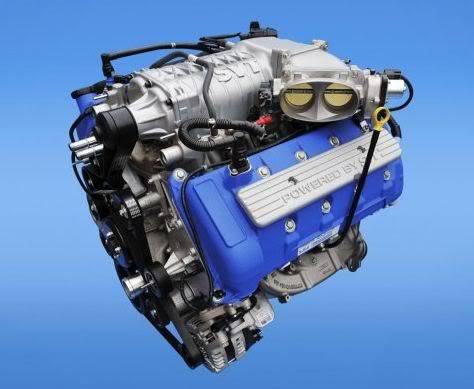

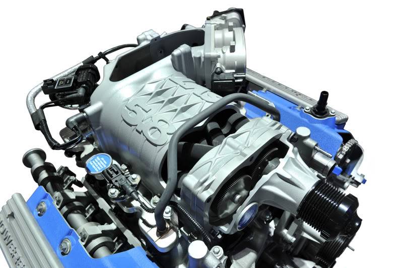

Aside from it having plated cylinders, GT cams and a new Supercharger there's not all that much difference. Just a Jmod on my trans and I'll swap one of these puppies in my Mark in a second :D
650HP Baby!
Not really that big a fan of these blowers but this one seems to make me rethink a bit :confused:

From wiki:
A 5.8L (5808 cc, 354 CID) DOHC 4-valve Modular V8 is introduced with the 2013 Ford Shelby GT500. The 5.8 L's bore and stroke are 93.5 mm (3.68 in) and 105.8 mm (4.165 in) respectively. It is essentially a bored-out version of the 2011-2012 GT500 5.4 L, retaining the 5.4's PTWA-lined aluminum block. The 5.8 L benefits from cylinder heads with improved coolant flow, Ford GT camshafts, piston-cooling oil jets similar to those found on the 5.0 Coyote, new 5-layer MLS head gaskets, a red line increased to 7000 rpm (from 6250 rpm), and a compression ratio increased to 9.0:1 (from 8.5:1). Boost is supplied by a 2.3L TVS supercharger. At the time of launch, the 5.8L will be the world's most powerful mass production V8 and will propel the 3,850 lb GT500 to a 202 MPH top speed, it will also remain gas-guzzler tax exempt.

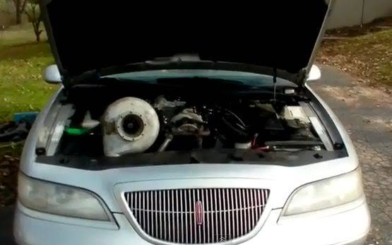

Will not fit. No way. That being said if I were to go nuts on a Mark I would seriously consider a Coyote motor and twin screw. But for that cost I could trump the HP by taking a Teksid, throw the $1800 Livernois bore/stroke kit, $600 for some C heads, $400 for all the Cobra intercooler stuffs, $3000 for a Whipple 3.4 and fit it under the stock hood all while making 1200 rwhp on E85 or around 1000 rwhp on 93. :)
Guess I would also need the $2400 T56 to handle that cause the 4R70 will grenade the first time it WOT shifts to 2nd. :lol:

Wow. Wow. Wow. There is tons of cool there. Aluminum, most powerful V8 and a 200 speed club rating........ time to start saving my pennies! :lol:
I LOVE the new Shelby body and with that powerplant....... *drools*
Then think about a smaller pulley and a tune....... will be a ZR1 killer. Gawd I love Ford.

What do you mean it won't fit? Will it just drop in and hood shut no, but anything will fit.

The 5.4 is also wider so in order to not be redonkulously top heavy you will have to mod the shock towers (ie; cut) and prolly do a hydroboost brake conversion. Then the real fun of steeing linkage and stuffs..... forget about AC too LOL.
Would be sick as fock, no doubt. But for the level of cost and mods, you can make just as much power with a properly built Teksid at a fraction of the cost and with no fab skills.
