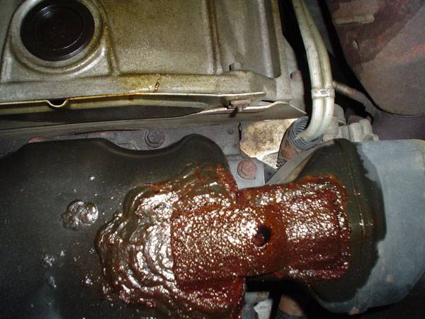

I was trying to change my fuel filter today when I noticed oil all over my tranny pan and exhaust system. I look over, and there's a rot spot in my oil pan! :Bang
So tomorrow, I'm going to fill the small hole in the oil pan with JB Weld or some other temporary fix. Then, I'll have to order a new stock pan, which my price, should be around $150 out of my pocket. I'll probably have to rent an engine lift and drop the k-member. What a pain in the ass!

I replaced my pan in the '93 (motor crapped out 100 miles later) without a lift or dropping the k-member. I just put one of those engine supports over the top of the engine, undid the motor mounts and then I think I only loosened the k-member bolts. If you can get an inch (after removing the oil pickup tube), there is just enough room to squeeze it on back. Barely.

Well, as a temp fix I JB Welded it. No leaks thus far. The oil pan will cost me $117, my price through Ford. As for installation aggravation price, I'll have to break-out the charge card...:D
