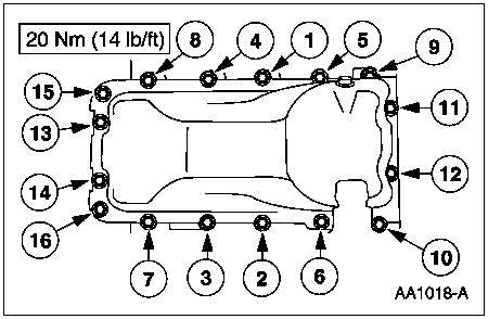

i never said it was the best, nor Mark viii specific, but it has the torque specs, maybe you can talk Bill into snapping a pic of the oil pan page and posting it
doesnt somone have the Mark viii Ford issue manual downloaded? i cant remember if Bill ever redownloaded it or not
I read the torque specs somewhere but I cannot remember if it was foot pounds or not. So I will not say the number until I find it again.
From the 1998 Factory Manual.
Tighten in 2 Steps:
1. 20 Nm (15 Lb-Ft)
** I know the pic says 14 Lb-Ft, but the spec chart says 15 Lb-Ft **
2. Rotate an additional 60 degrees
