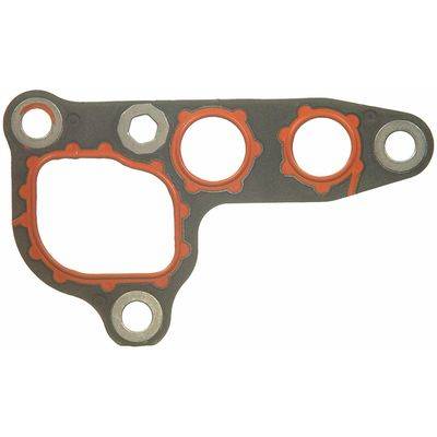

That oil filter adapter gasket leak is a common problem on ALL 4.6L engines, I've changed them several times at the shop.
Fel-Pro 70415 Gasket:
I have a spare one of these that i picked up brand new in a junkyard car. I guess they never got around to it. lol. It's ready just in case i ever have that problem again. It's a frustrating hour of your time. Probably worth the money. :D
