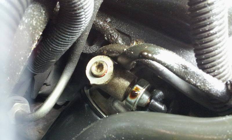

Anyway, it's not the gasket that's leaking, it's the sender but now I can't get it to leak. I wiped it clean, cranked it and laid there and watched it. Nothing! I drove it down to the corner store, about a mile round trip and still clean there where I saw it dripping this morning when it was cold. I'll check it again later but glad to know it's not that gasket because I wasn't looking forward to changing it. Now I have 2 new ones and no new sender. The place I bought the 2nd one from doesn't have the sender or I'd take it back and get it. It was only $7.00, tax and all.

I posted in the wrong thread. Don't know how I managed that one but anyway, the OPSU is what was leaking thankfully. It got oily under there before I knew it. I got the new part and some teflon tape. Going to replace it in about an hour or so.
This was before I wiped it clean
This was after it was wiped clean and sat all night and then cranked back up. It's leaking in between the grey section and metal crimped area.

I just fixed mine. Wrapped the threads 3 times with teflon tape and threaded it in. Took all of 12 minutes to fix. No more leaking. $6.00 a quart oil is too high for the concrete.
