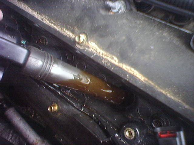

That is a lot of oil.............wow. I would be cautious about putting those coils back in the car when you do your valve cover gaskets. What does everyone else think???
I got all 8 replaced when the gaskets were replaced. Better safe then sorry. It was a lot of money to spend, but I think it was worth it.
I would just clean them very well. If they work now, they should be okay. It's the oil getting on them that ruins them, but if they're still good re-use them.
i repaced all my plugs and my #3 was full of oil i just cleaned the coil and replaced the plug and its fine now. i did it all about 2 months ago and checked it yesterday to see if there was anything that needed to be replaced, but everything was fine no oil what soo ever.
GOOD LORD THATS ALOT OF OIL!!! i had/have oil in my spark plug wells, but not on the boot, mine was more just little spots of dried up oil in the bottom...WOW!!!
funny thing is that theres no cel or noticable difference in the cars performance. Thank god I got the wholesale account with the lincoln dealer by my job. Im gonna have to do this on saturday. What a way to blow a day off. This sucks.
good work catching it before your parked on the side of the road - and kodos to you for doing the repair yourself :Beer

I like how it looks like a beach around your coil cover too. Both my LSs look that way too. That cover seal might need to be replaced as well.

no worries. every car has it's issues - the challenge with the LS is that it is soooooo over designed in some spots. They have redesigned the gasket to correct this issue - must have cost Lincoln a fortune.....
