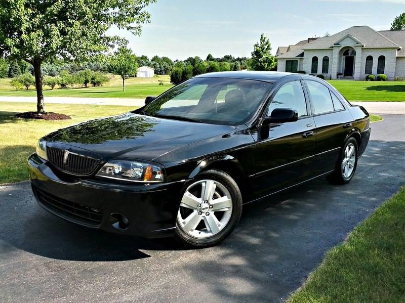

Here she is after Zymol car wash and Mother Cali Gold Cleaner Wax

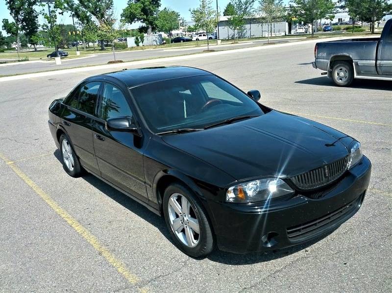

Random picture. Came out kinda cool lol
Man, I really need to get that front bumper taken care of... though upon further inspection of the picture I think a lot of that is bugs...
