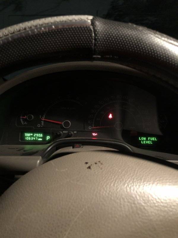

Yea all of that works cluster seems to be working properly the only thing is that the speedometer doesn’t light up because my headlights aren’t turning on brake lights ,running lights and rear turn signals all work but I’ll check out my fem
Here’s it is
I'd be much more concerned about that Low Oil Pressure light
