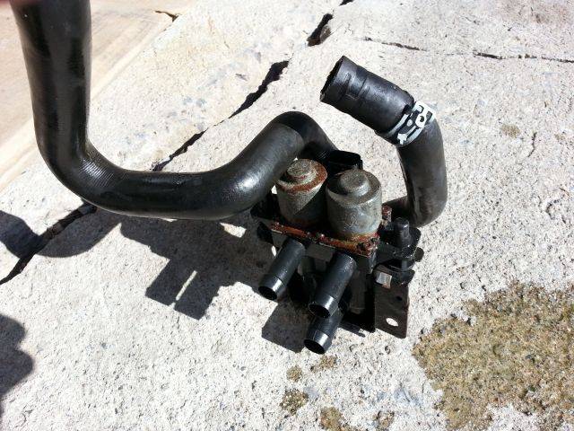

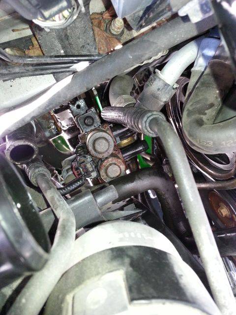

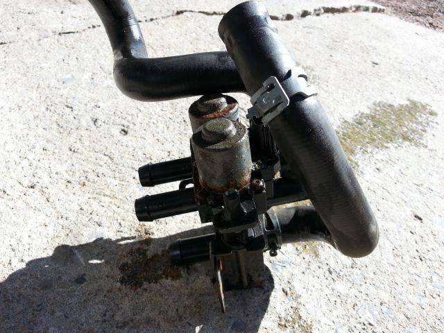

Your cold on driver-side but warm on passenger-side is a faulty DCCV. It needs to be replaced.
--- EDIT: could also be related to a faulty inside ambient temp sensor(s) but doubtful.
Why would DCCV stop the compressor from turning on?
