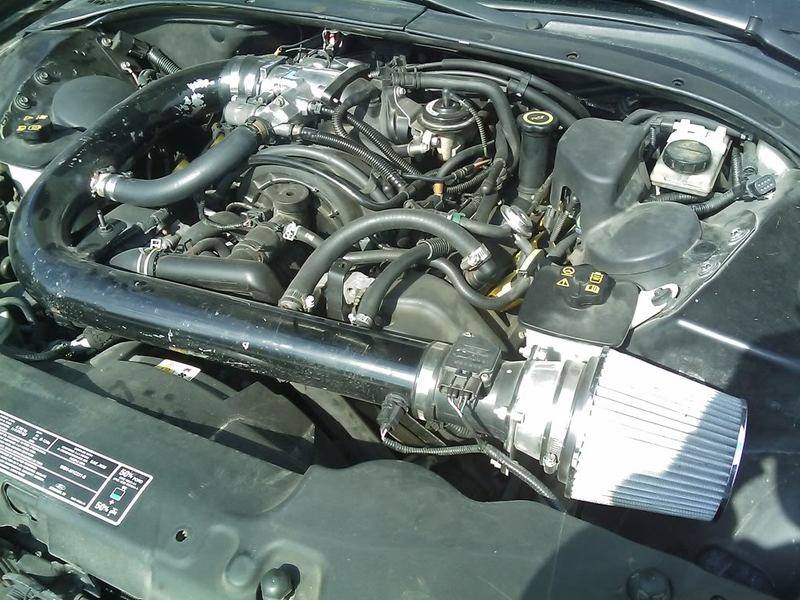

I'd run it to the back of the engine bay too, and cover it with some kind of wire loom. For the cops. You want your nozzle to be about 6" from the tb, and without any bends. the 6" inches being more important than the bend. I would also move the solenoids under the cowl or something. Hiding it from the heat and the eyes is the best way to go. That way it works the best and the cops or anyone else cant say anything. here is my engine bay.... find the nitrous. And yes I know its dirty and I have to clean up the welds on my intake. I just made a new one this spring and havent gotten around to cleaning it up yet.
i found it :D right over..................here^ (follow arrow up) lol bottom side of the intake tube
Htrdlincoln, thanks for the offer, where do you have the intake tube drilled? If it's too far downstream i'll pass... I want to move it down maybe 6 or 7 inches no more than that...

My intake tube has th ehole beteen the MAF and the ribs. Probably further away than you want.
