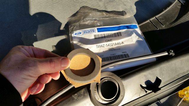

    It's the cowl seals, not the windshield seals/gasket that are the problem. Specifically, the seal around the passenger side wiper shaft is usually the problem. It is not changed when changing a windshield. There is a $5 repair kit available from Ford for this seal.

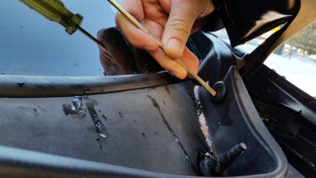

      Yes, the wiper arm cowl gasket will begin to allow rain water or washer fluid to leak down onto the engine appearance cover and thus running down onto the Coil covers potentially causing shorting of coils.
      HOWEVER ...

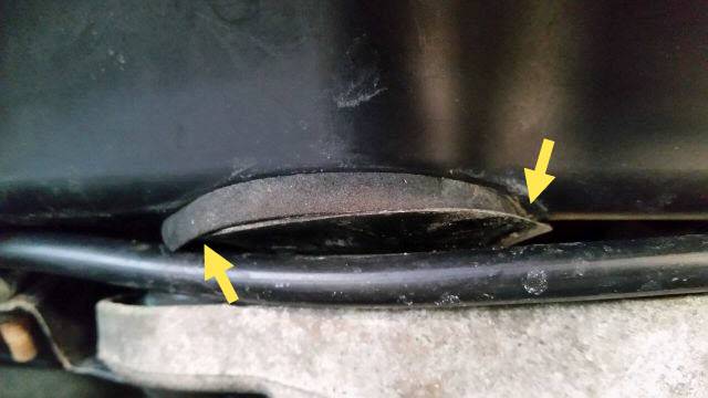

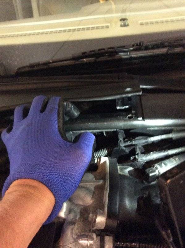

      the glass to cowl rubber seal, if not snapped into position correctly or properly, it will allow leakage down past the back side of the cowl down into the engine bay. It needs to be snapped tight to the bottom of the glass and zipped outwards, making a complete seal. Rain water or sprayed washer fluid can and will, run past the glass seal.
      See the rubber to glass seal? where my fingers are resting?
      That entire seal has to snap in and lock in place with the very bottom of the glass all the way across.
      Your opinion may vary ... of course.

      Re&Re - Wiper Arm Shaft Cowl Seal

        Thanks Rigs much appreciated I now know to tell the guy to leave the cowl off and I will reinstall it myself I took it off and painted both the driver and passenger side plastic cowls they turned out pretty good.... Can I buy the new foam seal at The auto store or do I have to buy it through Ford dealer?

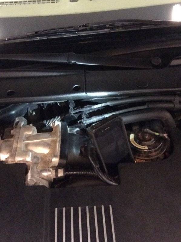

        It's a Ford part as illustrated. Suppose you could find other foam gasket rings like that but you'd want to be sure it's a perfect fit. Clearly a Ford specific designed gasket.
        You mean the left and right black plastic front glass trim? Those on the sides of the glass? I'm sure this is what you mean as the wiper arm cowl unit is one entire piece.
        ~ Clean up the wiper arms and give them a nice fresh coat of black satin.
        CAREFUL with those wiper arms, up in the extended service position without blades attached. Spring loaded, they'll smack down in a hurry and ruin your newly installed windshield.
        Be Fn cautious, kid you not!

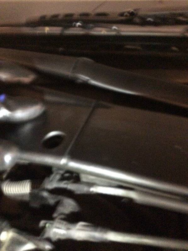

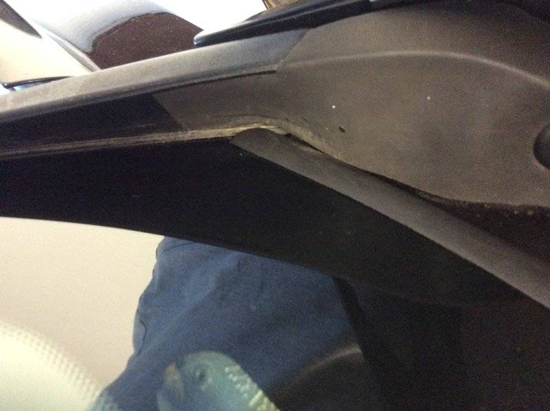

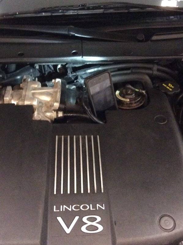

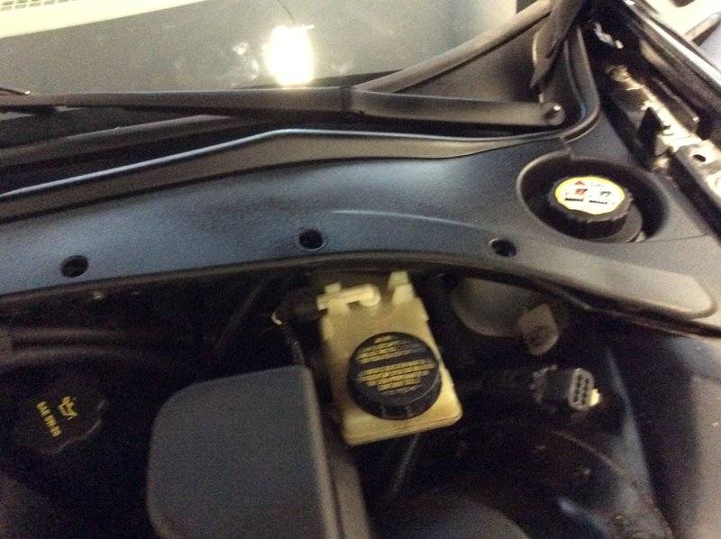

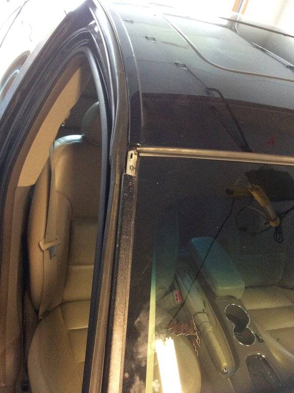

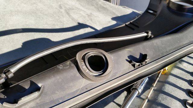

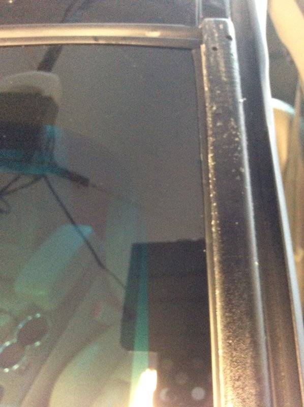

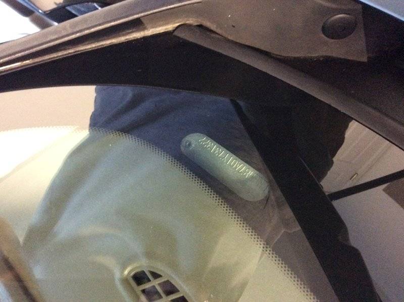

        I need to replace the two side plastic trim mine are shot. Do you know if I can still buy these from the dealer? I meant I painted the two plastic pieces under the hood that attach to the glass with the rubber here that is a pic of what I painted and a pic of the trim I need to replace also the plastic trim molding side pieces don't look like they fit like they use to now that the new window is in ....what am I doing wrong or did I break the side trim taking it out :(

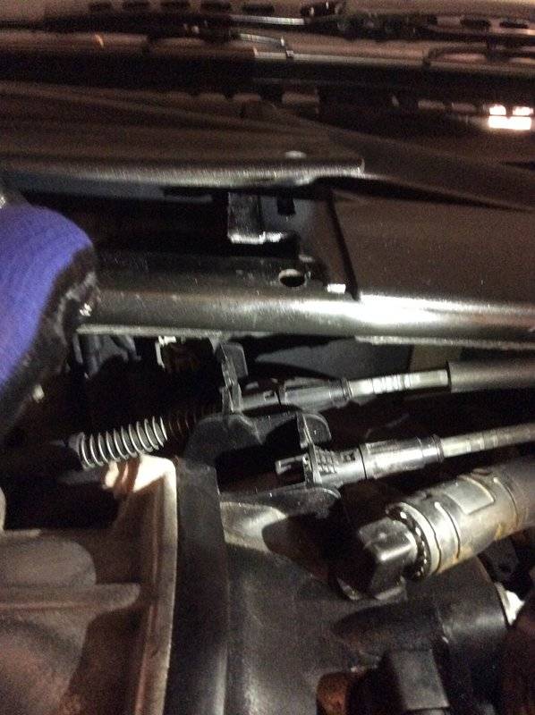

        IMG_1992.JPG IMG_1991.JPG IMG_1981.JPG IMG_1982.JPG IMG_1983.JPG IMG_1984.JPG IMG_1985.JPG IMG_1986.JPG IMG_1987.JPG IMG_1988.JPG IMG_1993.JPG IMG_1994.JPG IMG_1995.JPG

        I have it all back together and it's going to rain in Minnesota the next two days so I'll be testing it out to see if the cowl seal will keep water out I swear re hope so sounds like it could be a major pain in the rear if my rubber seal on the plastic cowl is warped or not holding a good seal I'll keep you posted ...thanks a million Rigs and Joe

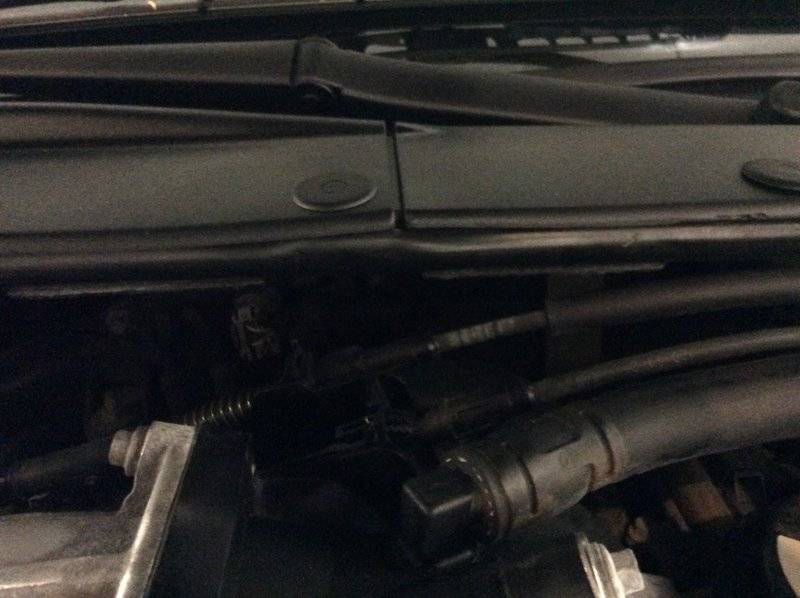

        Now that I re-read your post I guess I thought you were calling the two separate plastic pieces attached on the bottom of the glass Cowels.... I need to study definitions more on this car

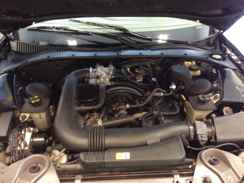

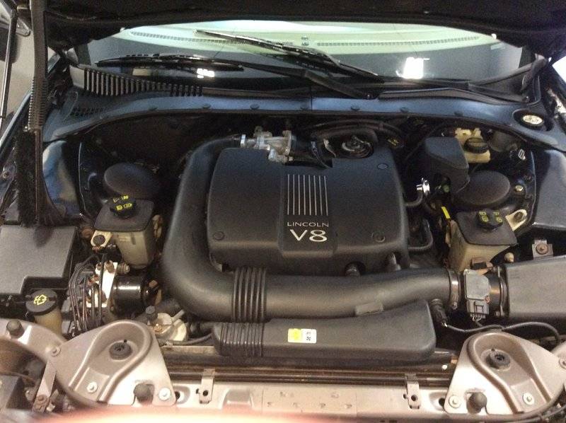

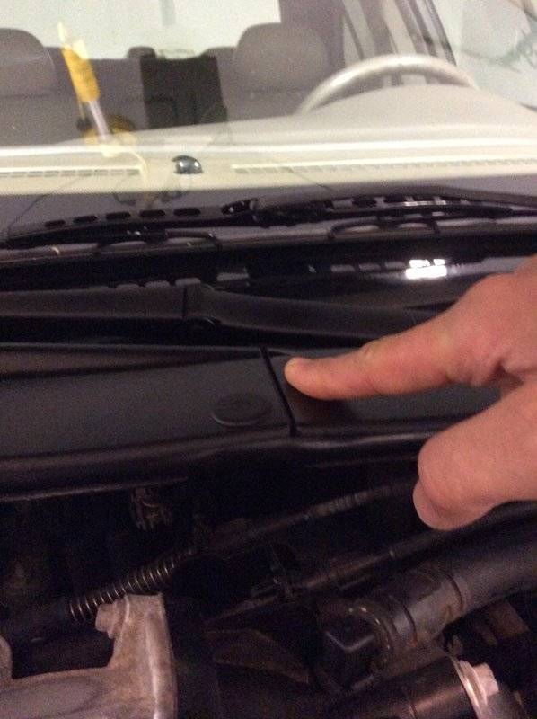

        Someone has broken or cut your cowl into two pieces. I would be very surprised if it doesn't leak now. It's just one piece on both of my LSes, and every other LS that I have seen.
        It looks like the cowl is still available, but at $1000, I'd look in the junkyards for one.
        XW4Z-5402010-AB - Ford Parts Giant

        Not good!!! Is there any after market cowls that come in two pieces that the previous owner could've put in because the driver side piece fits perfect under the passenger side piece like it's meant to fit like that??????

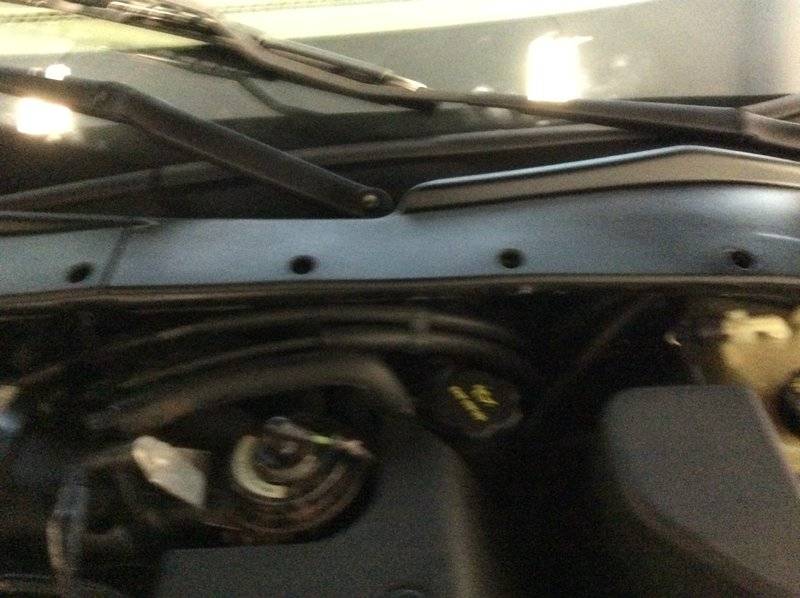

        Midwest
        I have a 2001 LS Sport it's a gen 1 not a gen 2 does that matter

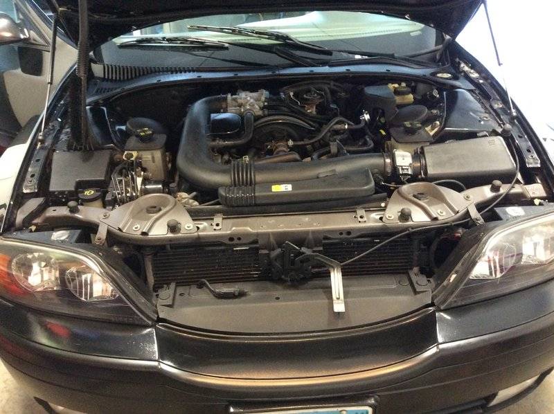

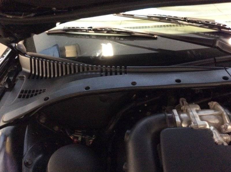

        IMG_2008.JPG IMG_2007.JPG IMG_2009.JPG IMG_2007.JPG IMG_2006.JPG IMG_2005.JPG IMG_2004.JPG IMG_2003.JPG

        Nope it's meant to be in half as you can see from the pictures the driver side is meant to go underneath the passenger side this very rare indeed....any thoughts Joegr

        That's somewhat odd. Was wondering what he was referring to as two pieces. I'm going to have to pop the hoods of both GEN's here today.
      • RigsLS
        RigsLS Dedicated LVC Member
        Messages:
        7,754
        Likes Received:
        510
        Joined:
        Mar 10, 2012
        Ain't that something, another GEN1 vs. GEN2 difference.

        Wow, didn't know that.

        I've had that cowl off several times some years ago, I don't ever recall noticing that either since working on the 03 full cowl when I replaced the foam gasket and refreshed the washer spray fittings.
