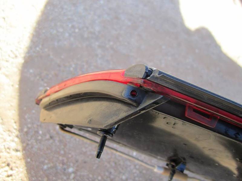

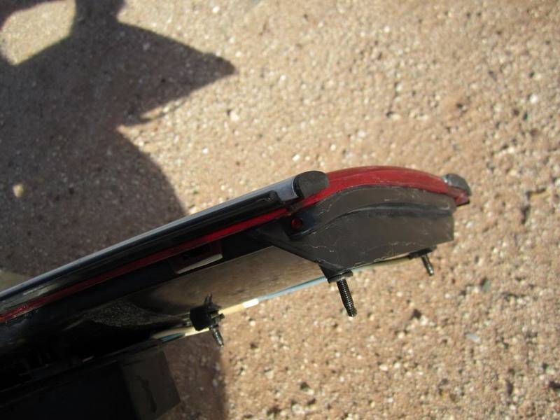

You'll want a Glitch Ballast to fix the trunk neon, custom thing someone was doing. As I understand it the original person who did it passed away(?) and his wife was taking care of outstanding orders. I don't know if you can still get them but it's what fixes the problem.
How do you dry out the housing? I guess I have to study up on that part. I imagine if I throw a ballast in without drying out I will wreck more stuff.

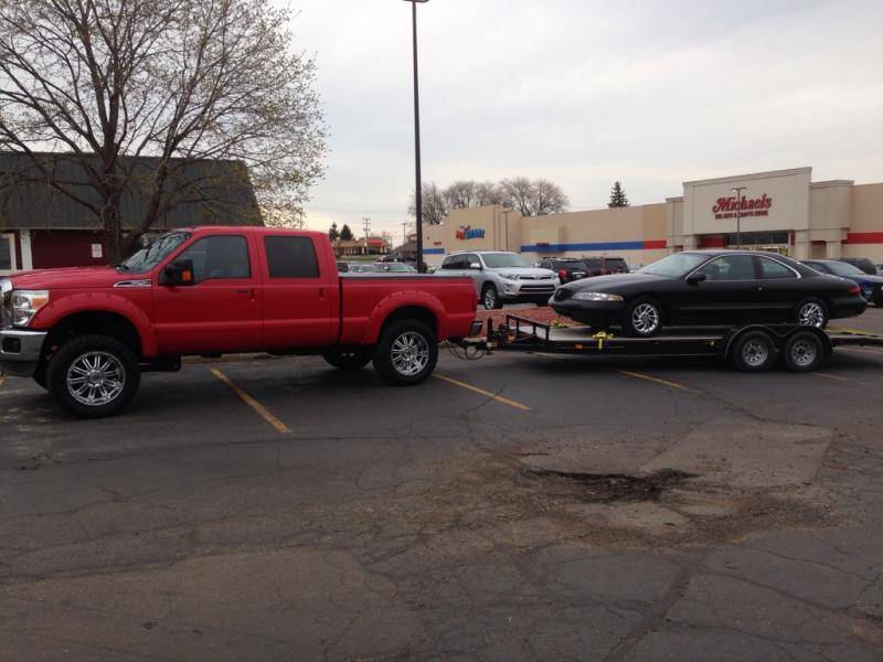

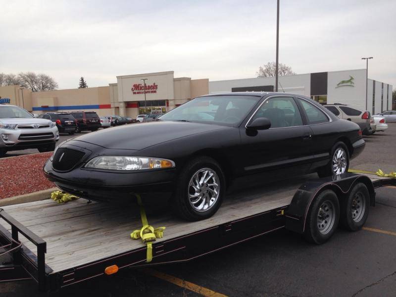

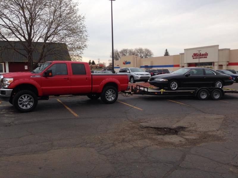

All loaded up! Grab some grub at Denny's and on our way back 250 miles[emoji53]. Wasn't quite what I was expecting. They knocked some more off. I almost drove away.View attachment 828472373View attachment 828472374
Wish me luck on the way back. Hope I strapped her down good enough! [emoji16]

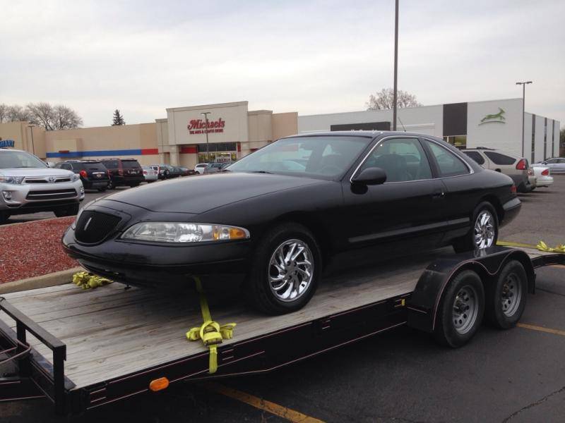

First & foremost congrats on the newly acquired gem. How does it feel to be back in the saddle of a Mark VIII after so many years? You know you got yourself a unicorn. Black on blacks are rare. However with patience, every once & a while you find a really good one. Glad you found yours.
By the way, what dimensions is that trailer? I'm going on my 3rd trailer in the last 2 months & none are comfortable enough to fit a Mark VIII & open it's doors without hitting the fenders. I'm getting ready to sell the one I have now to find a wider one.

For the neon, to get the water out (and left open won't allow it to collect), drill holes in the lower corners, that gets the water out, and depending on where you live and how much driving in the rain you do, you can just leave them open.
I borrowed the trailer from a friend. I think he told me 21'. I will see him tomorrow at the Jefferson swap meet, I can find more details if needed. I could not open my doors all the way, at least with me in it. With no weight in the seat you can open the doors with about 1/4" of clearance. Guessing about 12" from the fender to the side of the car with the car centered on the trailer left to right. I loaded the car a little farther forward than one should. I did it too level out the trailer another 1" or so. The drop hitch didn't drop quite enough to be perfectly level.
To get the car on and off I had to jack up the front of the trailer to keep from tearing off the bumper, didn't think to bring boards. The last time I trailered a car was 1990 something...

Thanks for the drain info! I live in SE Wisconsin so rain isnt really a thing for us.

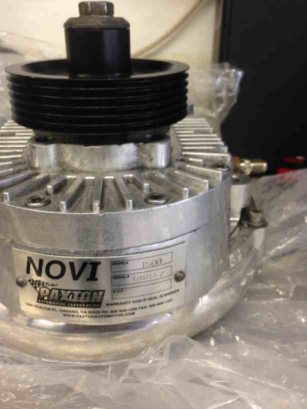

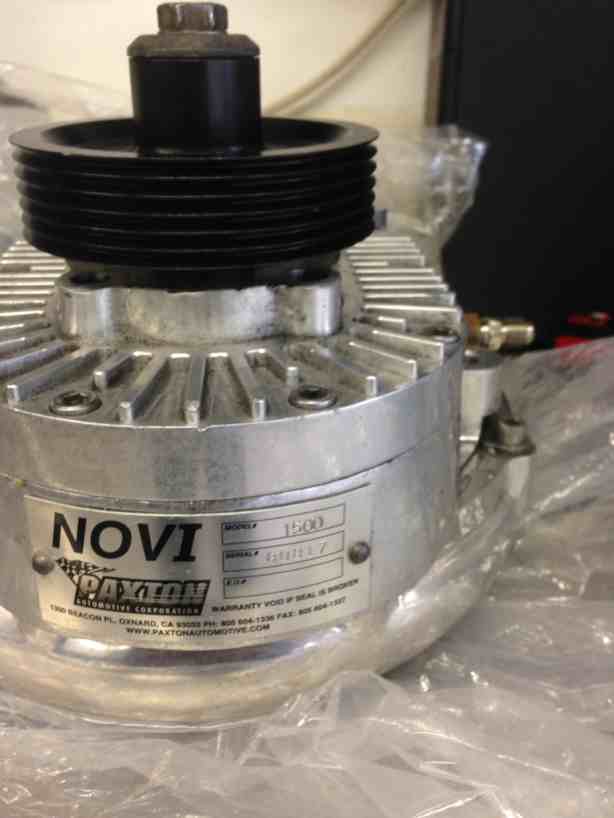

Today marks the first day of real progress, kinda. A couple months back I scored a posi carrier and 4:10 gears. Today I picked up a Paxton 1500 with some piping and blow off valve.
As I continue to accumulate parts I have come to a spot or two of extreme confusion. I have read sooooo many links that I have basically researched it to a fault.
Since mine is a 98 it seems there is a bit of concern over what fuel pump to get. Can someone bring closure for me? I am hoping to do just replace the pump in the tank.
Injector size and type recommended ...?
This is a street car not a track car. Not a DD but a weekend cruiser and car show kind of thing. 8 psi is the max boost, I want this to be relatively safe. Note I say relatively... 92-93 pump gas. No cooler at the moment but if I can find something between now and spring it may add it into the project.
A higher stall is in the plans as well, I will worry about that detail as I get farther down the road of the project. For now I want to focus on the fuel system and related charger parts.

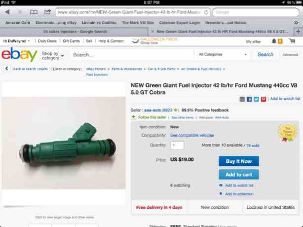

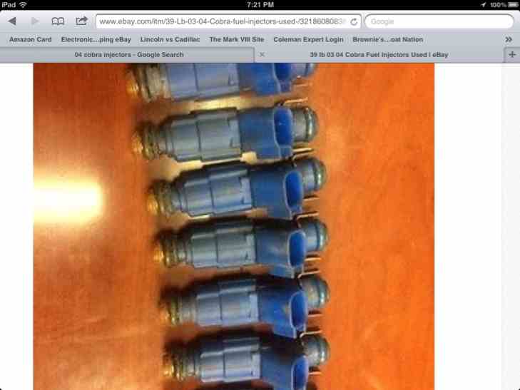

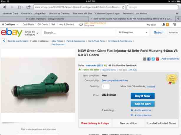

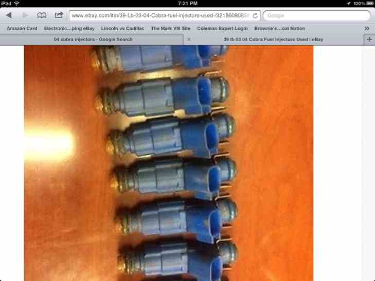

Any thoughts on injector size? 40ish? Or can I run what I have, stock?
04 cobra injectors probably. they are 39s.
should be available used in working condition.
that should support 8 psi with a big pump.
an aeromotive 340 should give you plenty of headroom at 8 psi.
I found these and I won't have to get adapters.
What is the performance difference of the large body and the slim body injectors?

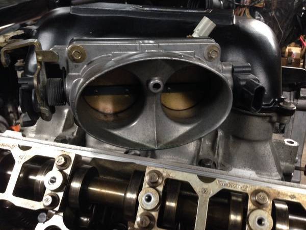

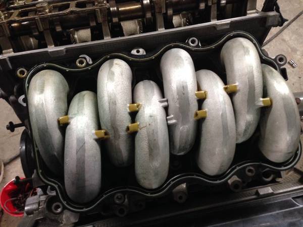

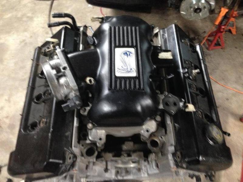

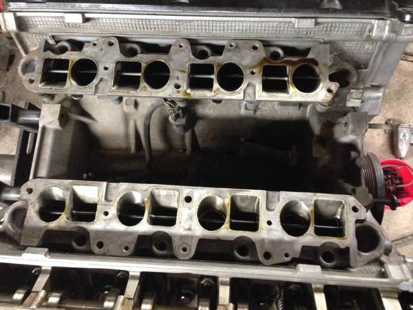

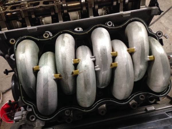

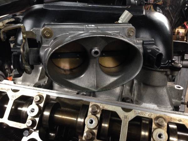

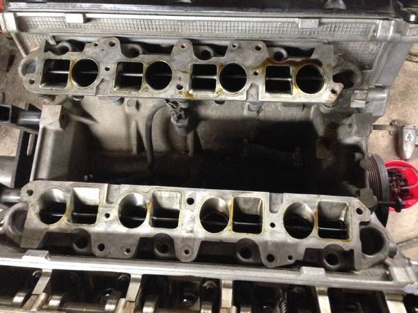

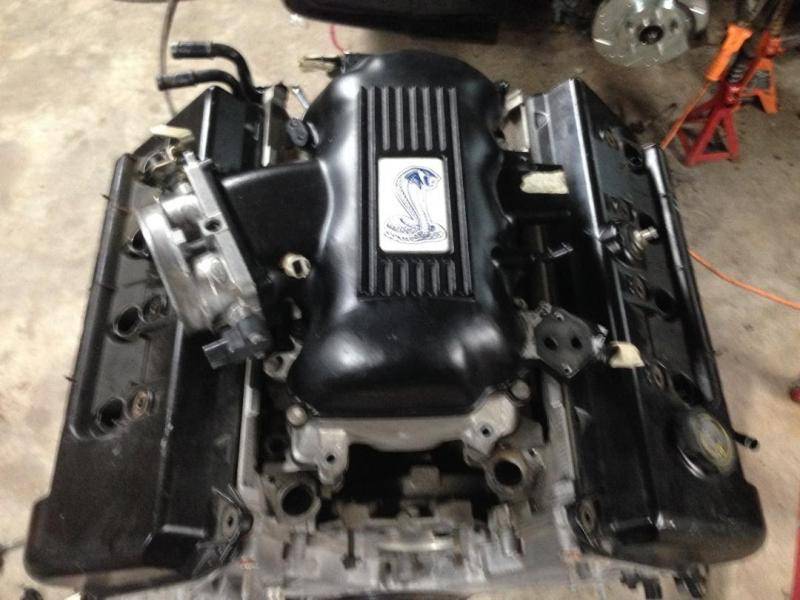

This week I was in Houston for training. While there I scored a cobra intake, IMRC plates, TB and all the bolts for $230...
I think I did pretty good. I kinda like the tophat being powedercoated black. The lower is still aluminum.

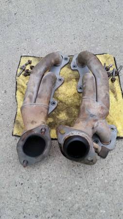

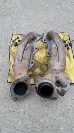

How do you guys feel about JBA shorty headers off of an 03 Cobra? They are asking $400
