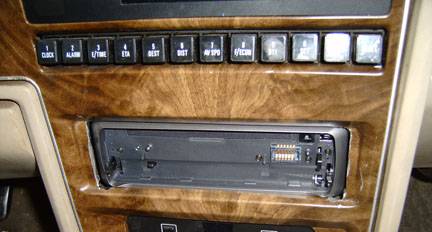

Pictures of radio facia
One_Way said:
How about posting some pics of what you have now, let's see what you are dealing with. :)
Here are the pictures. Took awhile to acquire a digital camera.
The first photograph is the dash in question. The second photograph is a sideview of my Bill Blast (yes Blast). Note the cardboard under her because she's leaking like a sieve.
Thanks for getting the pictures up!
That "gap" is truly minor. Though not an audio aficionado (nor grammatical genius) there has just GOT to be some aftermarket kit for situations like this. Maybe even a product that you cut to length and install in the edge of the opening like you would the edge of your door:
Second, nice car. Shame about the leak.
I had a Pioneer head unit just like that, and it can fit just fine. The issue with yours is that it is mounted with the plastic surround behind the wood trim. What you should do is mount the stereo forward some more so that the plastic surround can sit over the wood trim and it will look much better.
Two heads ar better than one Josh (even though mine is a cabbage).
I missed the frame hiding behind the BB trim work. Looks like abot a 1/2 inch adjustment. 1986_MarkVII, are you able to remove the wood tone trim and then the radio and then reinstall the trim and the radio frame/surround/reveal on the OUTSIDE of the BB trim?
I used plastic washers between the mounting brackets and the dash to bring the stereo out to a better location. It should only take about a quarter inch.
John, you better give that noggin some attention our you'll be smelling of sauerkraut. ;)

That's why I have you guys around. Thanks for pointing out what I didn't see in the pictures, Josh.
OldSchool1 said:
...Thanks for pointing out what I didn't see in the pictures, Josh.
It was pretty easy since I had a similar head unit at one point in time. Just doing my job. :cool:

I printed your recommendations and went to my Bill Blast (yes, Josh, the Blastmobile) and put the key in the ignition and drove the car to the dealer that installed the car and showed the manager your notes.
He apologized profusely that his guys had allowed me to drive away unhappy with the finished product. Something about the mounts and blah, blah, the stereo looks better. :p
