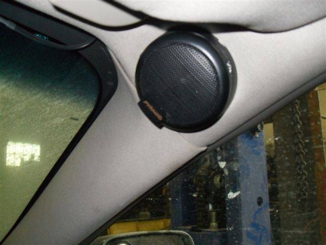

Put them here

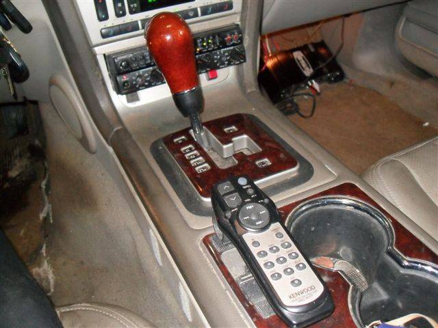

I put my remote here
used a piece of plastic water pipe epoxy'd to the remote and painted it black to get a good angle, ground the bottom of the pipe flat then used velcro which I had to glue down with epoxy also to hold well and not rip off when you pull off the remote.

No offense man but your setup looks a little out of place.
And the vehicle looks dirty.
Those eq's go way back to the early 90's...didnt know people still used them.
thats because most good HU's will have a 7 band or better with crossover built right in and its always better to have that work done at the signal source and have less devices that the signal needs to run through giving a bigger chance for signal loss or picking up distortion.

It's too much trouble adjusting eq through the HU.
My ipod songs are cued at different levels and I also listen to Mozart and Beethoven symphonies so I can mix the music how I want it.
The bottom eq is a 3 way crossover with gain controls.

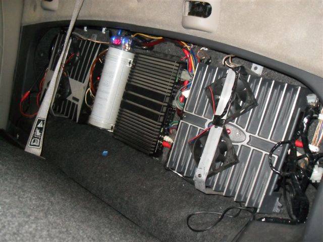

I use both the eq and crossover to control the volumes and eq's of the 4 amps that make up my 2000 watt monster stereo which with the coneless subs under the front seats will beat you up.
I have a musical experience in my car that regular stereo's can't match.
This is similar to a system I had in the 90's in a Gran Prix with 2 10 disc CD players so I just updated it in the LS.
To each his own.
Well if you have good soundstage and you dont boost all the freq's then i guess its good.
I would have just went about it in a different way.
I would have installed the crossover and eq in the glovebox or something since they dont match the color of the interior and intergrated the midranges and tweeters better.
As for the diferent songs you can always just create presets for the different types of music. Or if you really are that into music you can install an audio editing program on your pc and make all songs the same level.

Sometimes when the 2 12's hit with 1000 watts rms it feels like someone hit the car LOL!
As to the cap I had it for a long time before including it in this build and my lights don't dim at all if I crank it up.

Putting them in the glovebox would defeat being able to adjust them while driving which I do all the time.

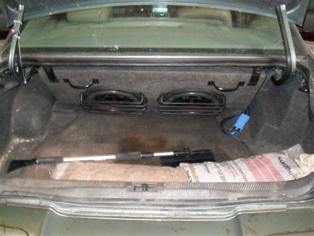

This sub box shakes the whole car and vents into the interior where the factory 6x9s were.

I like what I have and the way I can adjust things without having to use the touch screen or even taking my eyes off the road much.

I'm going to be remounting my amps with the rubber isolators soon so I'll get to the cleaning then.
