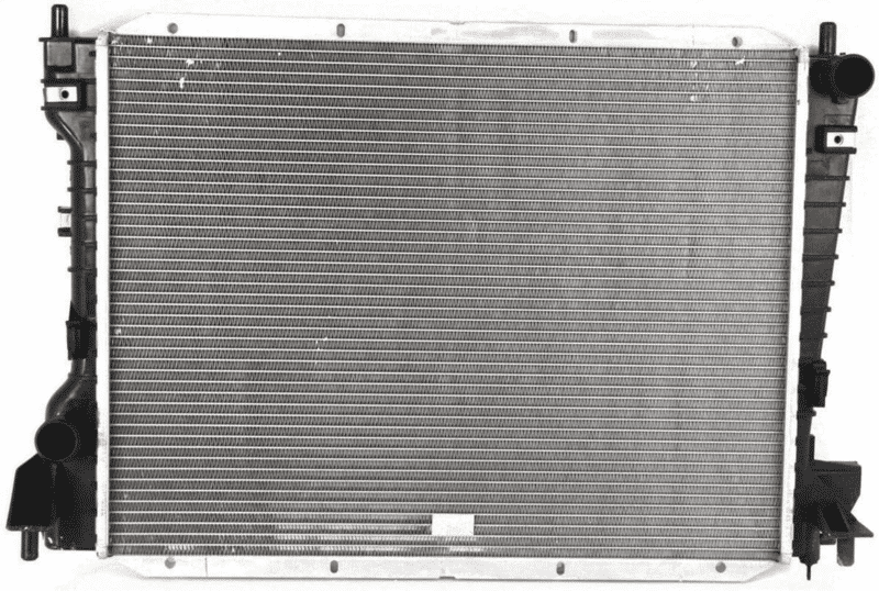

I feel like you are not understanding. The two radiator hoses attach to the back side of the radiator (fan/engine side.)
As seen here. Note the top hose on the right. This is where the hot coolant from the engine goes in the radiator.

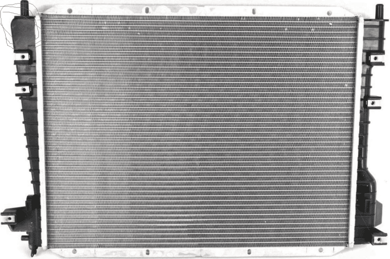

Now, look at the front side of the radiator (grill facing side). This view is rotated from the other view, so the top hose connection is on the left side of the image. I have circled in red where the hot coolant hits the front side of the radiator side tank. This is where it eventually cracks. If it is cracked, you will probably only see some powder residue.
Yes... that is the location... No... The hose attached to the upper radiator is not the issue, and there is no hose between the radiator and condenser.
Where the upper hose goes on the radiator... the coolant puts a lot of stress on the radiator at that location.
It eventually cracks... and discharges coolant in the form of steam.
No... YOU are not understanding.
In that pic of the radiator... the tank on the right is where the upper hose attaches.
On the BACK SIDE of that tank, is where the radiator blows out... but you need to remove the bracket that is holding the radiator in place, in order to see the crack.
Straight above the drain petcock, you have the the hole for the upper hose.
The BACK SIDE of where the hose mounts... will crack over time, and it can be easy to miss the steam leaking out... unless you are looking for it.
