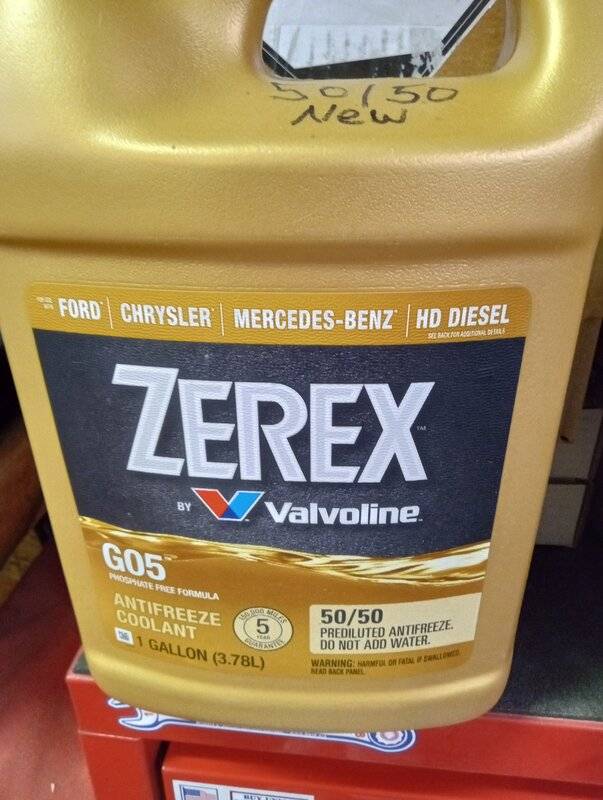

I also noticed he used green coolant. If I remember correctly when I got coolant for the LS when I had the water pump changed earlier this year, the coolant was orange.
Is the coolant supposed to be orange or is the color more of a brand thing?

Zerex G05. Ok. Thanks, Sport.
You will probably want to get the green crap out of the system first, as much as possible. Flush with water.
To get the proper mix, you will probably need to buy some "test strips" instead of using a standard hygrometer.
The tester on the right will not give an accurate reading on the G05 coolant.
