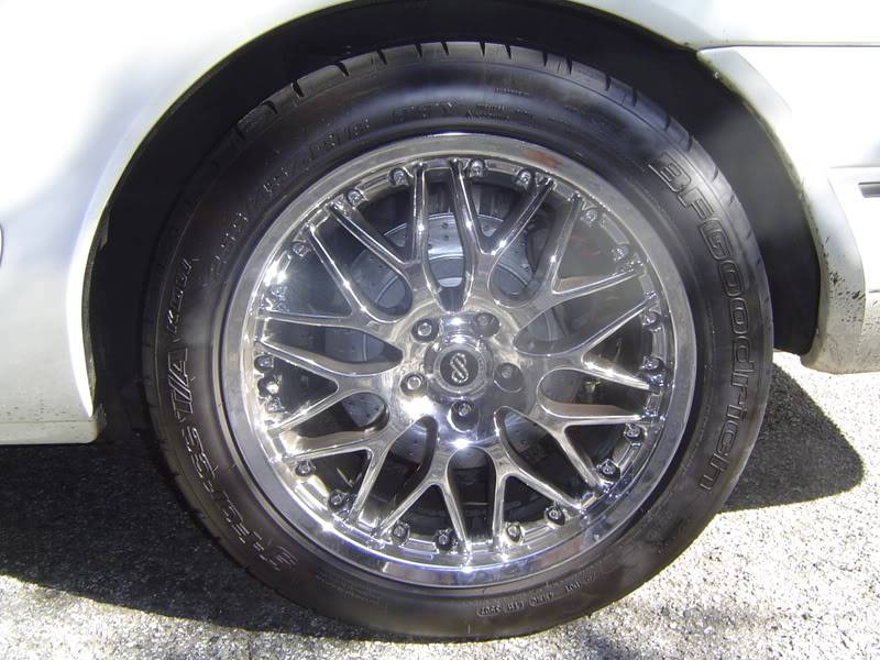

The work included a new/remanufactured engine and transmission, performance chip, replacement of the airbag suspension with coilovers, Adco sways front and rear, Kook headers with jet hot coating, K&N intake filter, dynamax dual stainless exhausts, high flow cats, AP Racing brakes up front and KVR in the rear, urethane bushings, Enkei LX 18" wheels with 255mm treadwidth tires, reupholstered driver seat (the rest was basically mint condition), and an XM satellite radio set up and GPS unit. The old amp was shot but I found one in a junkyard for less than fifty bucks and it is going strong. Replaced the radio/tuner with a new Pioneer unit with CD player.
The car runs like a dream and handles very crisply. The bigger footprint all around enhances corner turn in, braking and acceleration with much more grip, and the stiff sways coupled with the coilovers and shorter/stiffer tire sidewalls makes the car much flatter and stable in the turns.

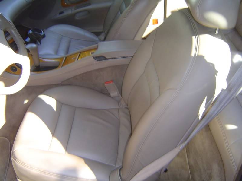

Are those the original seats???
The driver's seat was rebuilt in Pasadena by Sorensen...leather, foam padding, everything, to original spec, though the leather feels a bit better than the rest. The passenger and rear seats are original. It was her business car so basically nobody ever sat in the rear, and rarely in the passenger side..usually just her briefcase and files and such. It was kept garaged and detailed twice a year. With SoCal weather there is no rust or corrosion anywhere. She was the only driver, no accidents. Quite a few door dings from the parking lot wars, but the paint is original and the Dent Doctor was able to do a very nice job with the wounds, as they were all minor blemishes and none chipped the paint. She bought the car new in January of '93 for about $43k. Which for an American car in that time period was quite a pretty penny. I saved the original 16" wheels, but cannot put them on with the BBK that is now installed.
