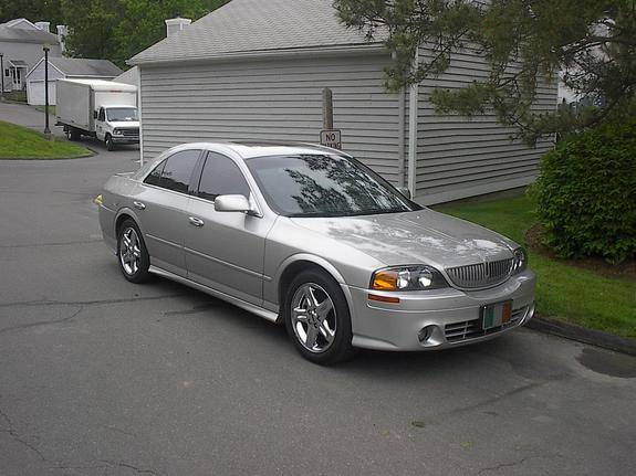

first off, im new to lincoln, been a pontiac owner for 2 years, it had to go. i picked up this 2002 lincoln LS 3.9V8 in trade for my 04 GPGT.
full Borla exhaust with cutouts, has the 06 LS chrome rims on it. 94,000 miles, clean as all getout. so far ive installed 8k low beams, and 6k highs. with 3500k fogs.
here's a picture before my questions.
overall, wow, i love it. although i have a few querks i'd like answers too.

Welcome to the forum. Nice LSE that you have. Paint looks good on it. The rims are not from an 06 LS they actually first generation chrome rims that came certain LS cars from 2000-2002. To answer you first question, that will be your clockspring. It's located behind the steering wheel so if you are not inclined on taking a steering wheel off then let the dealer do it. As far as aftermarket lights, check ebay. You can find some lights with the clear turn signal and angel eyes installed. Search through the forum as you will find a lot of information on different mods. I'm sure other members will chime in on some of your other issues. Once again welcome.
Sweet ride dude. WELCOME!
One thing though, those are not 06 wheels. They came on some 00-02 model years.
EDIT: haha LeaSr beat me to it.
Welcome!!! Extra nice LS you have. Great to have another enthusiastic owner join the forum.
Welcome to LVC. That LSE looks just like mine when I bought it. Yours looks like it was tken care of a little better tho.
You can find tinted fog lights on ebay. Headlights are all factory, none custom are made. You can take them apart and take the amber lens out and change the bumper blinkers to clear also.
