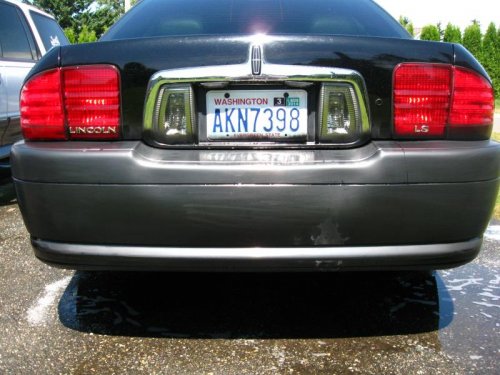

Sanded and filled what was needed, shot primer wet sanded that, then shot the base coat wet sanded that, shot clear wet sanded that and then went to cut and polish it all out and my not so trusty polisher crapped out on me, so now Im waiting on parts to repair polisher so i can finalize the paint work.
I'll be adding to this thread periodically to update the progress of bringing new life back to the LS so stay tuned.:cool:
Finally got my parts for my polisher so i could get started on bringing the paint back from wet sanding, just finished with it and here is the results from all my hard work, got a lil over spray to clean up but other then that I'm really stoked about the outcome.
Nice work on the bumper! Looks like a great LS, enjoy. With all that mechanical work out of the way it should be a great car.
Did you do that paint work with a spray can?
Yes it was all done with Duplicolor spray cans.
Really ?
That's amazing results for rattle can. I read you wet sanded and did the clear, then wet sanded again. then polished it.
very nice results IMO
Kudos!
Kudos!
Yes really all out of rattle cans, you just have to spray a lot on and pack some patience and follow through with your wet sanding steps and then onto cutting it then polishing/waxing it.
+1
May just do my own bumper covers then ... can't wait for my neighbors shop to free up any longer.
It all comes down to patience, a steady hand and following through with each step, I hear yeah on the shop not being available I just couldn't wait any longer knowing I was driver the LS around looking like it did, that's not how I roll :D
PNW...the new rattle can master. Very impressive work. Looks like you've done alot to revive your LS. Keep it coming...it will become an addiction if it hasnt already
Ha lol! ;) as most of you already know once you start on these cars with the goodies or like myself revitalizing, its very hard for it not to become an addiction, which is a far better addiction to have then some others.
