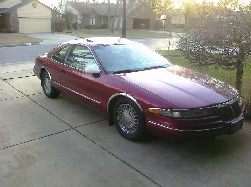

Hello, ive got a 1995 lincoln mark viii bought in kansas city for 1300, it has some problems including an engine shudder that comes and goes, the cats are clogged also so im hopeing that is what is wrong. the car sat in a field for over 6 months so i saved it from rotting out there. it was to much car for the guys teenage daughter when she drove it so its beat up in spots. i know im going to need help with info on this car so thats why i joined. its an awesome car always wanted one and now i have it. Thanks
