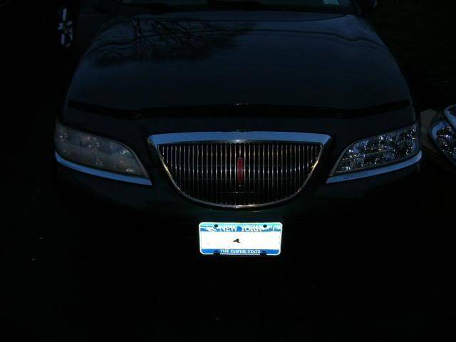

After sitting in my living room for two weeks waiting first for the HID kit then decent weather I finally got me new headlights on. Both original HIDs worked fine but the housings were very cloudy and after hours of polishing with mediocre results I knew I wanted new ones. The halogen housing were an early Christmas gift from Heidi and I got an HID kit from mafioso. Ford makes you buy a kit with a new SCIL module but since I was going with HIDs still I didn't swap it. Install was strait forward and not hard except the polarity is reversed on the stock headlight wiring so the HIDs wouldn't come on. One call to mafioso and a little wire splicing and I was good to go. I cant figure out how to remove the stock ballast though. As far as I can tell there is a nut and a screw holding the bracket on but after removing them it still won't budge.

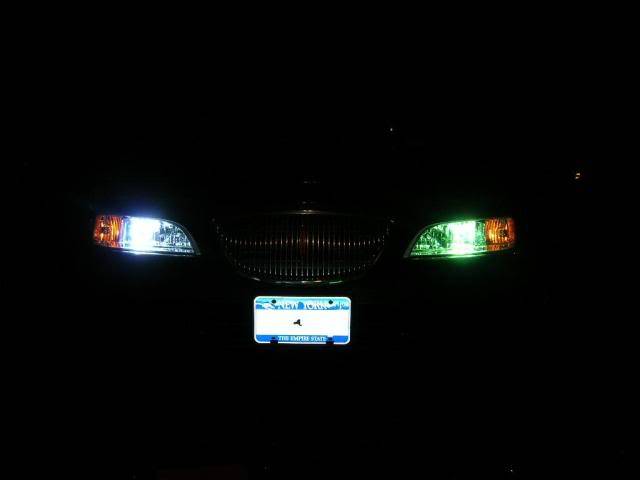

One 6000k bulb and one green tinted bulb. I put both 6000k ones in and will leave the green ones for shows and stuff.
