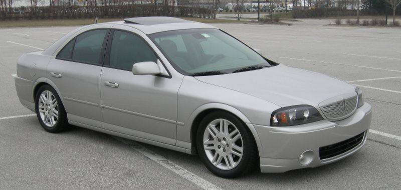

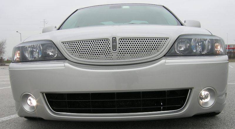

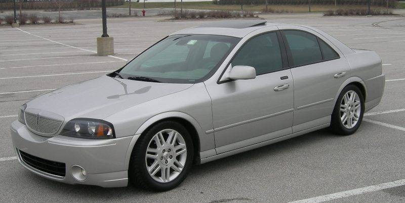

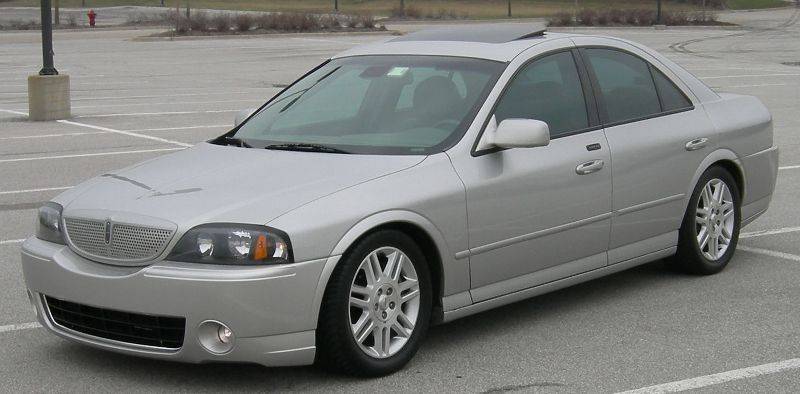

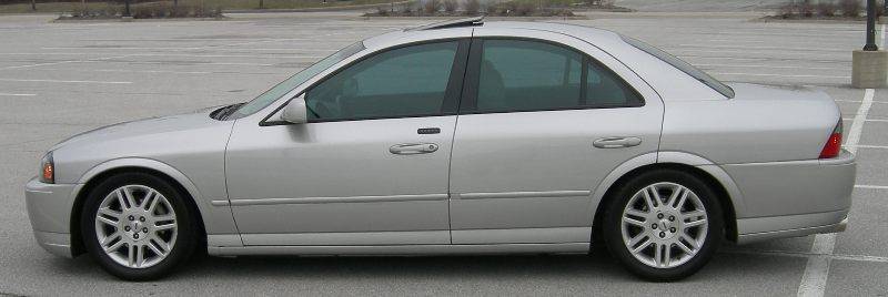

Replacement pictures, the first ones werent too good.
Here are better pics of the swap. Notice the CAI in the front drivers side lower grill.
GrayGhost1 said:
Looks great! The McLaren grille makes it look even better.
And all thanks to you Ken!! Everytime I go somewhere I get compliments on the grill. People love the McLaren grill.

Thanks!! Hers a low down of the install. I may take pics just to show what Im talking about here if its unclear. Its a very simple job, I didnt get any instructions on how to do it, I just went at it and figured it all out quickly.
1. Remove all front bumper splash guard bolts from underside of the car.
2. Remove both headlights. Each has 3 bolts to hold them in.
3. Remove front air temp sensor and plastic cover that it sits on from top of bumper cover under the hood.
4. Remove inner wheel fender liner bolts that attach to front bumper.
5. Remove brackets that hold the bumper to the front fenders. They have 2 small bolts and are easily accessible with a very long 1/4 ratchet extension.
6. Pull bumper up and forward and it just pops off.
7. Once the bumper is removed, you will need to cut off the stock fog lamp connector and splice in a H8 connector for the different bulbs.

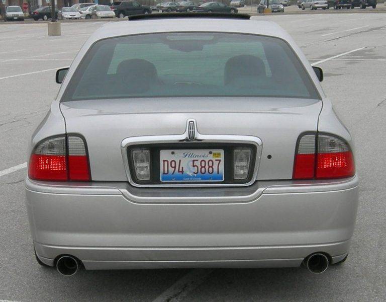

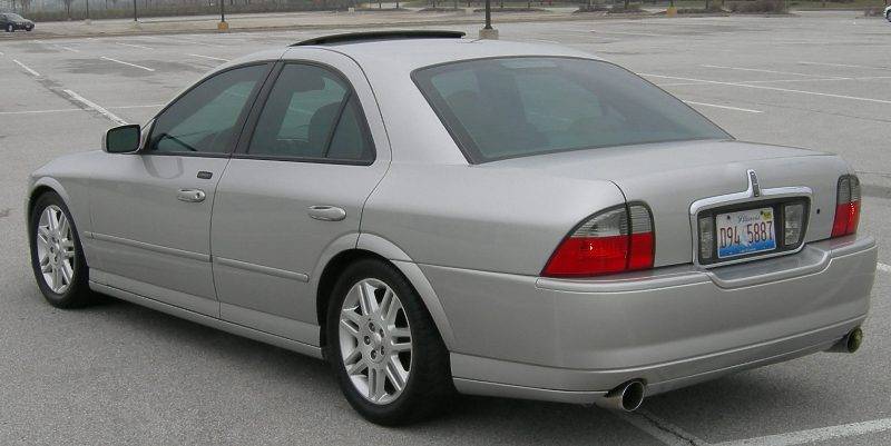

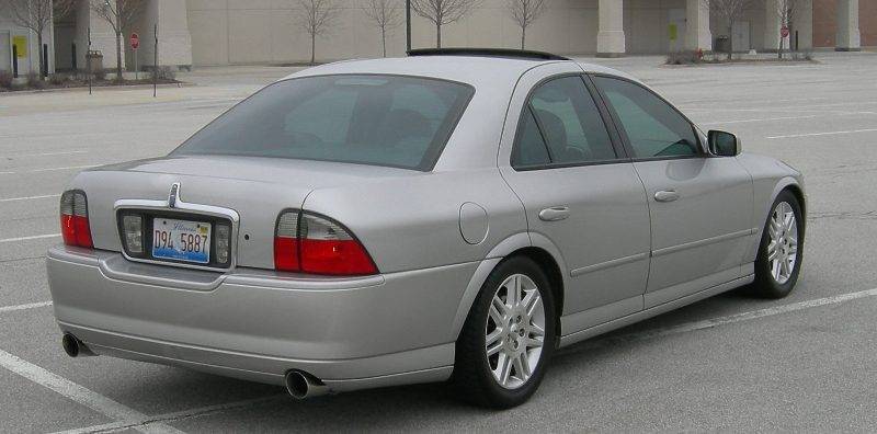

Yes, you can even put the 06 front bumper on a 00-02 as well. The LSE does have different moldings on the bottom of the car which are painted the same as the car color. The plain Sport moldings and LSE moldings are totally different in shape and material/plastic. My car was a plain 04 Sport. I bought all the lower moldings and bumper from Team Ford and had it all painted at a body shop. You will also need the painted rear license surround and front grille. The LSE also has all red tail lights, which I only have 2 of the 4 on so far in my pics. The last piece on the LSE is the spoiler. Its probably cheaper just to buy and LSE than to piece it together like I did. :)

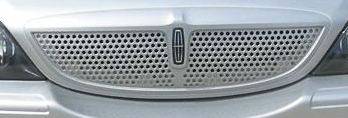

That's a real nice ride. I like all the up-grades. I will comment if you don't mind. I have the McClaren grill on my car too. I noticed that you can still see the holes that don't go all the way thru the grill opening. Now go get some black touch-up paint and paint those holes black to make them look like the rest. Aslo get some black duct tape and tape the hood opening around the under the grill to make it look black also. You will see my pictures later and get the idea of it.

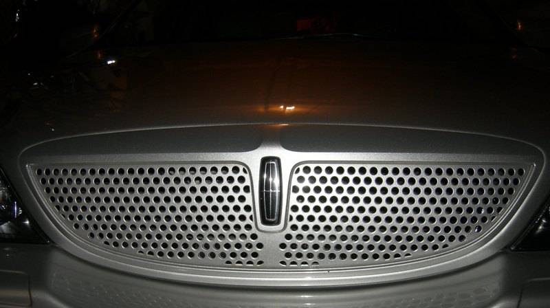

Leo, thanks for the comment and the suggestions!! You have a BEAUTIFUL LS yourself. I just went to fill in the holes with black touchup and I painted the silver metal behind the grill with black spray paint so the silver doesnt come through. It does look much better now. Its the small details that get over looked but make a difference. Thanks!!
Before and After.
Much better like that, that was the only thing I didn't like about those grills. With the blackout looks much cleaner.
Before and After.

Yea I have to agree with everyone, it looks nice. Click on the below link and there is a picture of the lower part of the McLaren grill. Yes they do make it. http://www.lincolndde.com/albums/lowermclarengrille/MCLAREN_WITH_WORDS.jpg
The lower grille you see is nothing more than gutter guard at WalMart. They come in black, white and green. It comes in a pack of 5 pieces. It matches the wholes of the McLaren grille really good. The length is about 36 inches so it will only fit the LSE front lower air dams.
