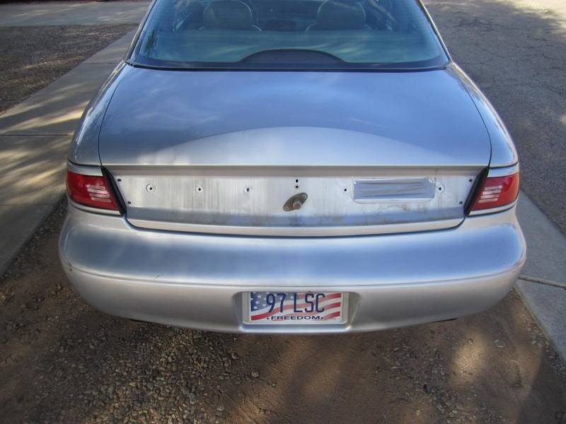

You need to remove the trunk lid liner (or at least the part that attaches to the back), and everyplace in this picture there is a hole there is a nut on a stud. Make sure you don't drop them in the trunk lid, because you will never see them again.

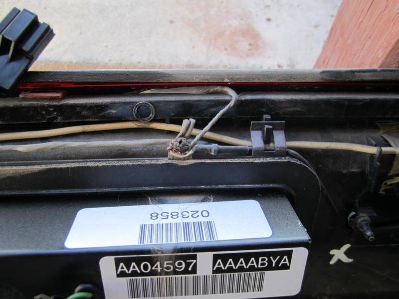

Disconnect the connector to the inverter before removing the panel.

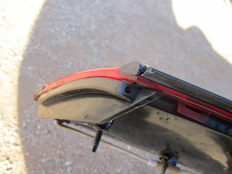

To get the inverter off I had the cut the head off this screw:
don't forget to add the drain holes, I think that no matter where you live (rainy, dry, etc) that you want to do that. Mine was full of water all the time, but now I never see water in there.
