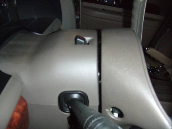

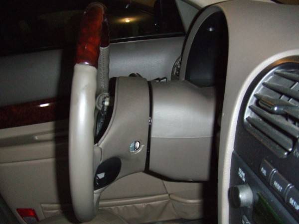

Ran into another problem. I got the right tool and replaced the steering wheel. After I tighten the center torx bolt, I notice a small 1/4 inch gap between the steering wheel and the column. I never noticed it before the swap. I need to know if this is always there and I never noticed, or is the steering wheel not on all the way? I have tightened it as tight as I can get it thinking it would push itself in when tight with no luck. Any help from someone who has done this swap would be appreciated. Thanks.
Here are a couple of pics to show what I mean. It doesn't look right, but then again I never took notice. And to beat everyone to the punch, I'll clean my vents when I get this straightened out. TIA.
