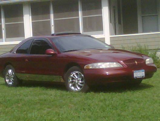

I just checked out this 98 LSC collectors edition Mark 8. It is fairly clean with only 77000 miles a little bit of work needs to be done that I could see, such as, door lights are missing lenses, the window button is broken, and the front headlamps lenses are all fogged up. the front and rear bumper looks to have been resprayed (decent), and while I was sitting in the car I could hear the air ride compressor kick on, sounded like it was coming from the passenger side somewhere, its red with tan interior, sunroof, loaded, the guy is firm with $4500... is this car worth it? how do you repair the fogged up lenses? are they available aftermarket? there is no rust on the car except for the undercarraige showing rust here and there... but not rot! surface rust. tranny fluid was pink, oil was tan, traction control was turned off for some reason.
what do you guys think?
here are a couple pics...

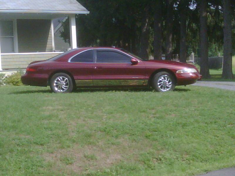

that's chrome sounds like a good buy...except the chrome.LOL when you said the traction control was turned off is there a check ABS warning or something like that, because the traction control, if you shut it off, turns back on automatically when you restart the car.
yeah its a big strip of chrome along the bottom of the car. the traction control indicated it was off and there was an airbag light on the dash that was illuminated come to think of it... I started the car a couple times while i was there and it never reset itself. Obviously there is a problem but is it something I can use to talk him down, I wonder if it would be an easy fix.
is that something a backyard mechanic can repair? A buddy of mine has one of those code readers, do you think I would be able to use one of those to find out what the problem is? thanks

That is funny, because my CE is the very same color minus the stick on chrome strip on the door.:p All of the issues that are happening are easy to fix. My CE had the ABS light on and the T/C light was on. The solution to this are ABS sensors that are on the inner axle shafts on the rear of the car. They are connected one on each side in the trunk, and fed throught the floor. The sensor is held in place by a 10mm bolt. Easy fix. That will take care of two lights at once. I've never had an airbag problem before, perhaps someone else will chime in there. I vote get the car, and complain about the issues to get the price down.

If you get the car, I got your abs sensors, on one condition, the chrome on side has to come off!

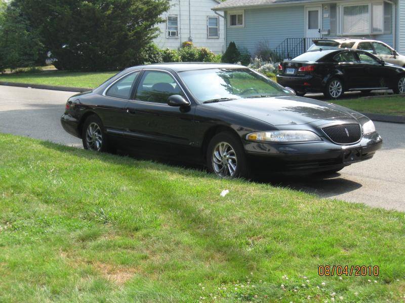

what about this 98 lsc? this car has had the blend door replaced, 77000 miles, black on black asking $4500
I'm partial to black on black cars myself, but Collector's Editions are up there pretty high on my list also. It all depends on what you want...

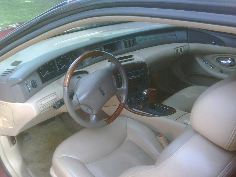

Contact Max at Five Star Ford. The ad is on the right side of the screen. First call your local Ford Parts dept, then call Max and be amazed at the price difference. You can't go wrong with the CE, as I have the very same color. Is the color the Prarie Tan or the charcoal? Also, check the telescoping steering wheel, it will not doubt be faulty. Either wont go up and down or in and out. If it is still doing both, then great. Everyone here with Gen 2's have the same problem. If it has a sunroof, open and close it a couple of times, and tilt it up and down. I would also, if he lets you check for leaks.
hey there,
it has the tan interior, sunroof didnt leak and the steering wheel went in and out and up and down as it should have... not sure about the blend door but I'm pretty handy with my tool kit. its blowing cold now and I wont be driving too much in the winter so it may not be a big deal, its the other electrical issues that have me concerned. the traction control and the abs lights....but like you guys said it should be an easy fix.

here is a pic of the interior
