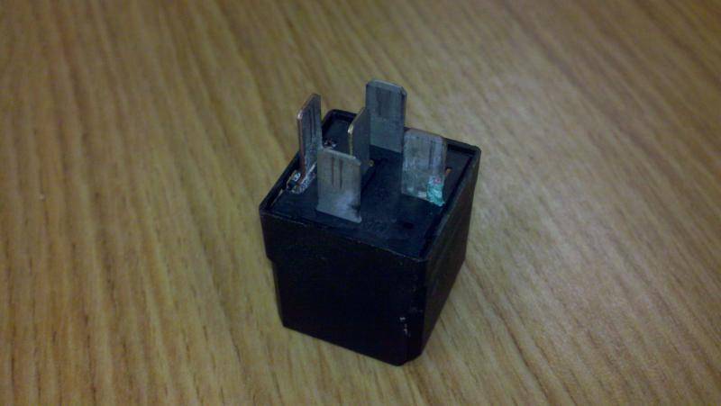

if it helps, when i pulled the pcm relay out, there was like a tealish/green thing on it but i scraped it and it came right off
Was it on the contacts (the external ones, not the internal moving contacts)?
heres a pic
I'd replace the relay and clean and bend in the relay socket contacts, or replace those too.
ok i replaced the relay, and sprayed contact cleaner on everything, but ever since i scraped some of the corrosion off and switched the relays around i have had no problems what so ever
dude!
Dang those are some dirty contacts! When you're not busy, take out all the relays and clean the contacts, check fuses too for corrosion. This exercise will save you some time in the future.
