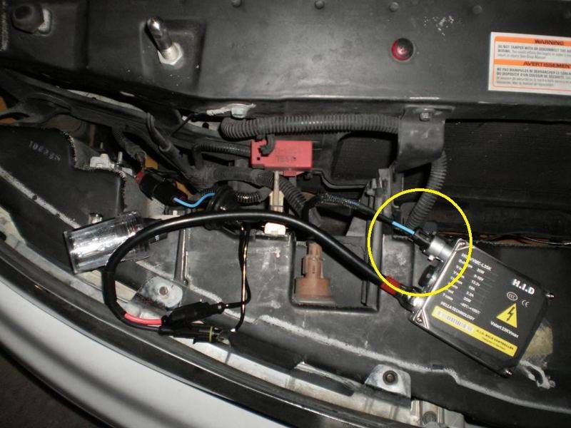

Ok so about 2 hours ago my 35w 4300 HID kit from vvme.com. I went and read the directions and its pretty much plug and play, really hard to fu*k up. Well they wont turn on at all, its hooked up they way the directions states but im getting nothing, heres some pics...
Im wondering if the wires need to be switched??
I'd say the wires are backwards too possibly, or it's possible the ballast needs to be grounded to frame?
Do you have some jumpers that you could test them right from the battery to the ballast harness?
Ok i went back outside and flipped the plugs around and they work........for about 5 mins then the drivers side goes out. I can mess with the wiring on that side and it will turn back on for another 5 mins, any ideas???? All the harnesses are connected really good, it almost seems like the wire has a break in it.
you might need a relay harness, the cars stock wires are too small of a gauge to supply ample power to the ballast.
Well i went and rechecked everything and the drivers harness was loose, the clip on the factory harness wont hold the connector tight enough to keep a good connection....so i zip tied around it and went for a bumpy 25 min drive and everything is working good for now. Ill keep the stock bulbs in the car just in case. Heres some pics.
