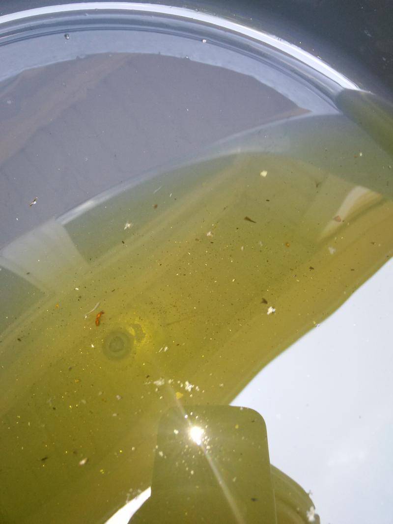

Theres been no oil in the coolant yet and I've drained the rad 3x now. The coolant is very clean minus the metallic and copper flakes i found in the bottom of the pan.

...Theres been no oil in the coolant yet and I've drained the rad 3x now. The coolant is very clean minus the metallic and copper flakes i found in the bottom of the pan.
I don't think that your oil-to-water cooler has failed yet. I think that the copper flakes that you see might be the internal cooling fins in the cooler corroding away. If so, eventually the copper separating the coolant from the oil may corrode through as well. That's when you would have oil and coolant mixing. I wonder if your car was run for some time with just plain water or with worn out anti-freeze...

Here's a pic of some of the metallic flakes I found in the coolant I saved. Its been outside so there's some bugs and stuff in there that did not come out of the radiator. The only thing that came out was coolant, some metallic flakes and very small copper colored flakes. There's not much of the copper and I can't get a good pic of it.

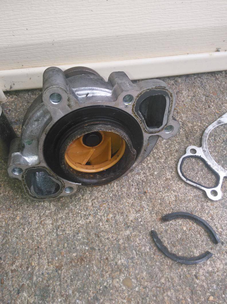

Got the water pump off today. The impellers and everything looks intact but the plastic on it was very brittle and came right off as I pulled it out.. I guess this would have started leaking within the next year or so.
I'm sure this is the stock water pump and with 138k on the clock I can say ford makes a really nice water pump. uploadfromtaptalk1435859039850.jpg
