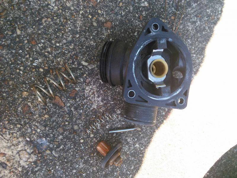

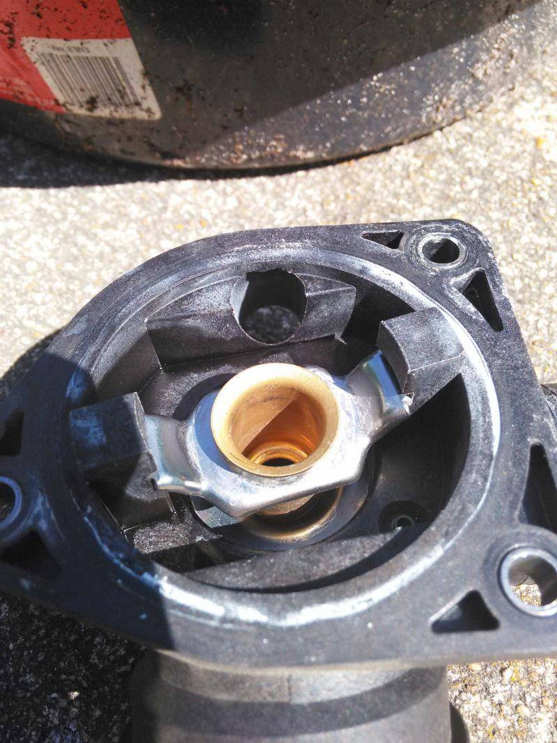

          Here's some pics of the thermostat. It literally came out in pieces. The plastic clips in the housing that secure the thermostat in the housing were still there.
          I'm going to drain the coolant again and take the degas bottle off in a few and see what its looking like. There's no coolant leaking out of the system I am confident about that.
          This LS has about 138k on it. The motor still runs great so if I have to take the whole system apart I'm going to. Its my favorite car I've ever owned.

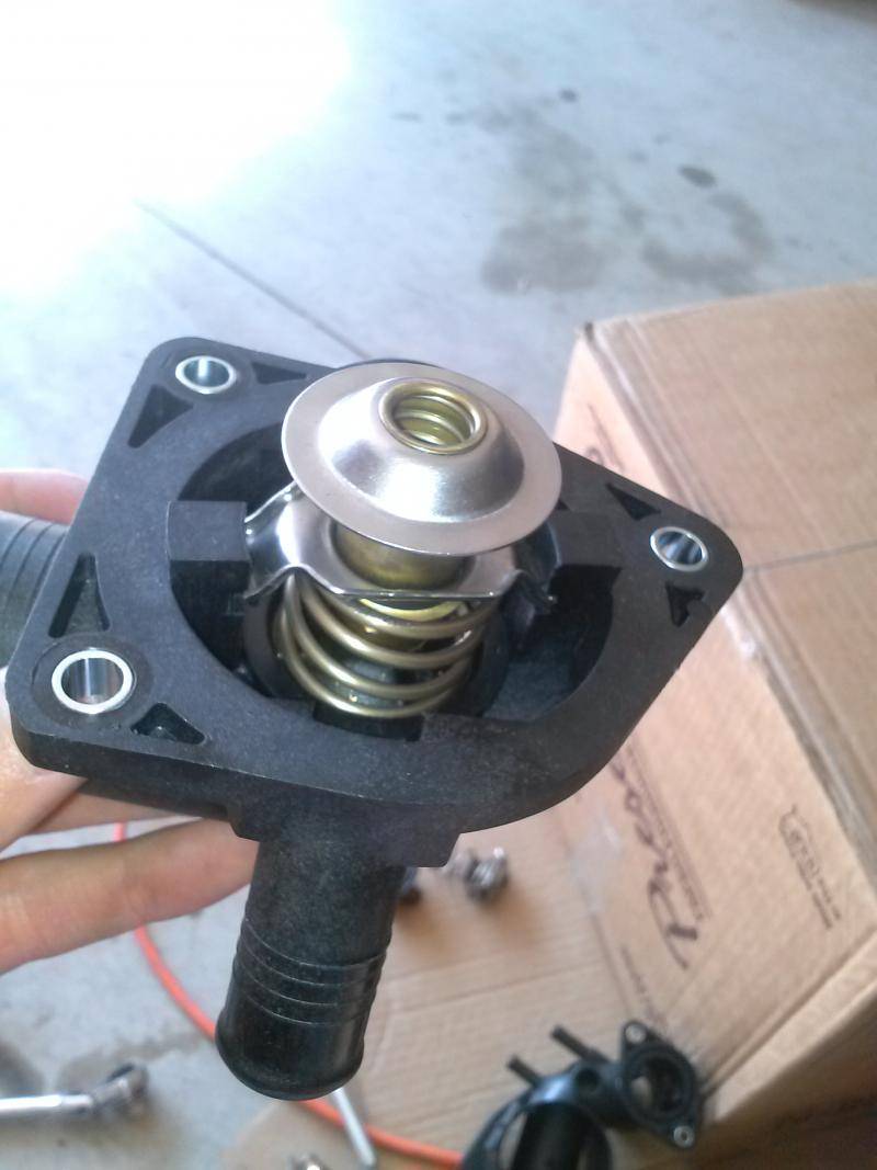

            I would say for sure it looks like your thermostat was put together incorrectly as the part that is still in there is in there backwards and it is supposed to hold all of the other pieces in there...
            do you think you might have also assembled the new one incorrectly?
            it should look like this assembled
          • peter.bucker99
            peter.bucker99 LVC Member
            Messages:
            20
            Likes Received:
            Joined:
            Jun 26, 2015
            Location:
            US
            The new one looked just like that. I noobed up and bought the housing with the thermostat already installed.
            I will admit that I've been battling myself as to if the new one is functioning properly.

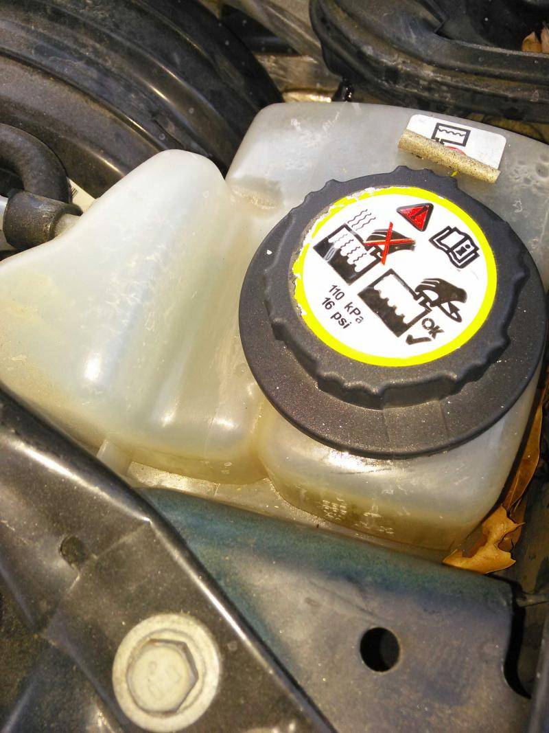

            Upon further inspection the degas bottle is yellowed. It doesn't look that great anymore now that I took everything off and really got a good look at it.
            Thanks for your help and the pic! Its much appreciated.

              I ordered the degas bottle and the rest of the plastic cooling components minus the upper and lower rad hoses.
              I'm betting you were right - degas bottle will fix it

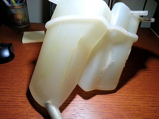

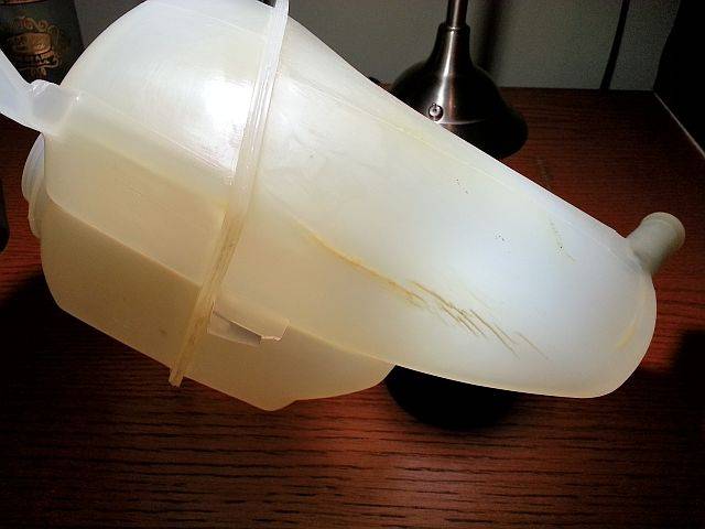

                when bigRig did his, he posted some pictures, you couldn't really see any cracks from the top, but there was definitely some on the bottom half...
                • Like Like x 1
                • RigsLS
                  RigsLS Dedicated LVC Member
                  Messages:
                  7,761
                  Likes Received:
                  516
                  Joined:
                  Mar 10, 2012
                  ^ Yup, Yup, seems they all develop cracks at the back/side and near bottom of the bottle, which of course is so far and tight onto the firewall, you can't tell from looking at front or on top. (plus hood cowl in the way)
                  Even while it's out and all dirty it's somewhat difficult to spot, rinse it off with some soap and hold it up against or near a light and you'll see the hair line cracks.
                  As we all know, one dead give away is when it's leaking a small puddle directly behind the front drivers side wheel. Overheating or not.
