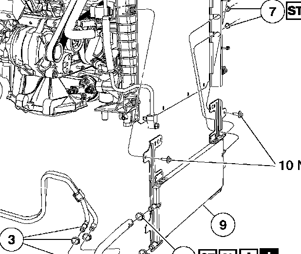

    OK, it seems that the Transmission Oil Cooler is damaged because its leaking really bad right above where the oil line attaches to it. I thought maybe it was just coming from a loose hose clamp, but I put a heavier duty clamp and it still leaks badly. When I put pressure on the hose to try and push it further onto the oil cooler, I could feel the cooler port moving as if it were cracked and more oil started spurting out.
    In AllData, it says that the A/C Condenser must come out since the cooler is mounted between the Condenser and Radiator. Has anyone ever changed one out before? I don't really ant to disconnect the A/C System if I dont have to and I don't really see why you would, because both oil lines are accessible from under the car. The only other thing is just removing the nut or whatever is attaching it to the radiator housing. Plan on doing it in the morning and I was super surprised that a new cooler is only $40 at autozone!
    Any help is much appreciated..Thanx

    Number 9 is the cooler and u can see where it connects to the radiator
