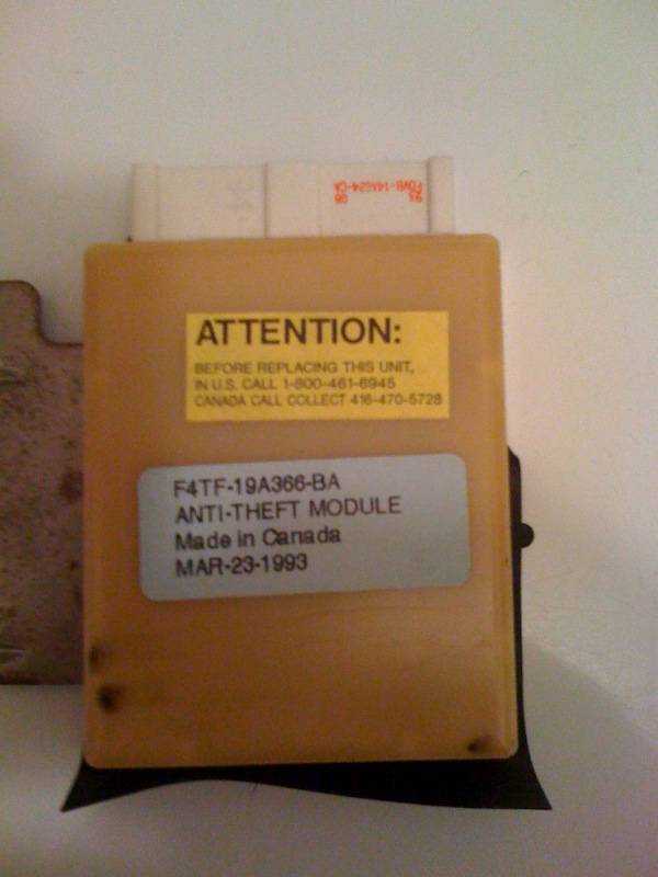

Its a yellow/tan module with 2 white plugs going into it and there should be a sticker that says "Anti Theft Controller Module" or something to that effect. It's located right behind the glove box, easy to see and get to. After looking at the electrical trouble shooting manual, you should be able to unplug both connectors on a 93 with no ill effects to other systems.

Here is a pic of the module, its from my 93 and with it removed, does not affect anything except the alarm is disabled. The remote still works the same along with the panic button.
The highway thing could be the alarm switch sensor under the hood. I disconnected it on mine but did not fix it, I just removed the module.
