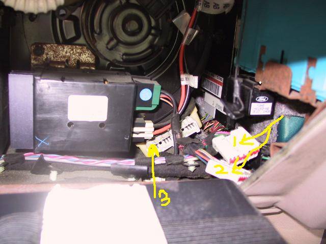

While I was behind my glovebox reprogramming my key fob, I noticed this connector (#3) unplugged. The 2 plugs (#1-#2), look like they belong in that connector. evidently the previous owner has disconnected this for some reason.
does anyone know what this connector and plugs are for?
It is right below the blower motor behind the glovebox.
Thanks in advance for any help..Joe

factory alarm module. horn must have been going off all the time so someone unplugged the alarm module.
B I N G O

but usually when the horn goes off constantly, you dont have to unplug that module, 9 times out of 10, the problem is the switch that is mounted right next to the air box under the hood. there is a rubber boot covered alarm switch under the hood on the inner fender and when they go bad, they'll cause horns to blow off at random and will cause the alarm to go off when locking the doors with your key fob, but it wont go off when locking the doors with the key. confused yet lol?

yes thats the anti theft conn.
the horn beep on lock and the panic are seperate from the alarm system
FYI, sitting on your fender will do nothing, so will giggling the door handles. You have to breach the vehicle in some way. Hood, trunk or doors.
you guys were right. its the alarm. i armed it and opened the hood and doors and nothing happened. when it stops raining ill go out and plug in the connector and see what happens. thx for the help!
