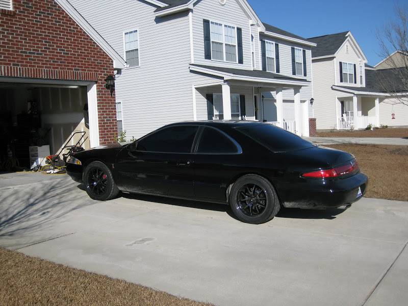

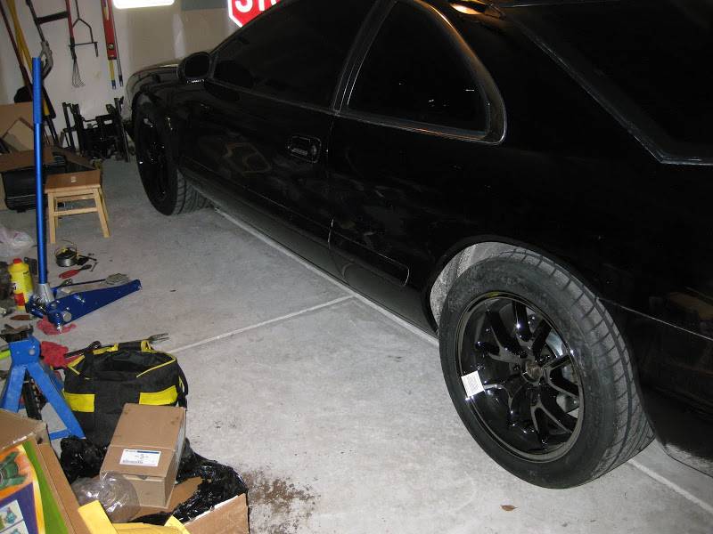

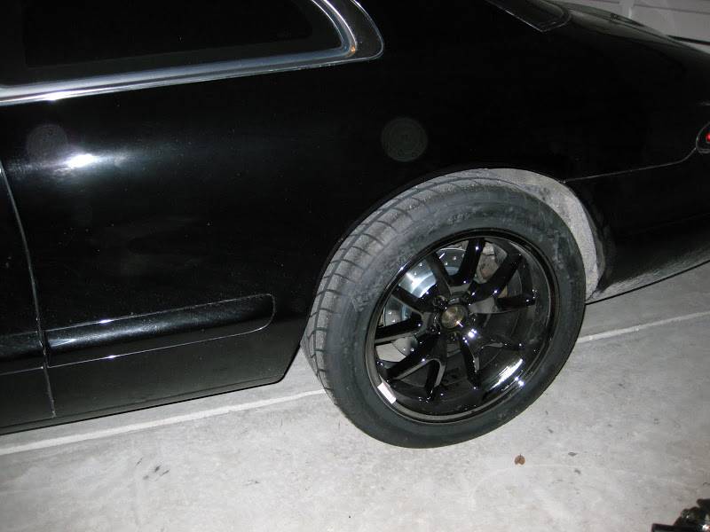

Now I just need to do something about the chrome around the side windows and it'll be 'murdered out'. haha.
DO NOT PAINT IT. I did on my crown vic sport 3+ times and no matter what I did I couldnt get anything to stick to the stainless. I tried with and without self etching primer. You should look into 3m trim tape. Check the LS forums, those guys were just talking about it. If I could go back and do my vic again that is the route I would go.
Why not take the trim off and have a professional in the autobody field spray it down.
I am sure something sticks.

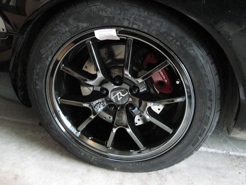

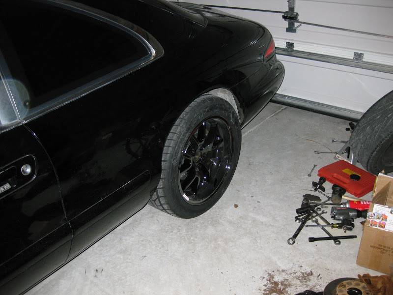

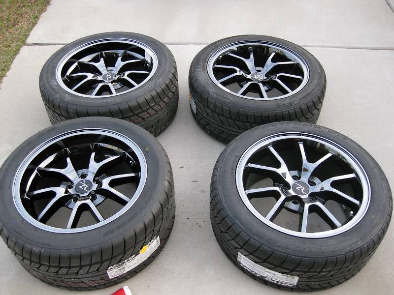

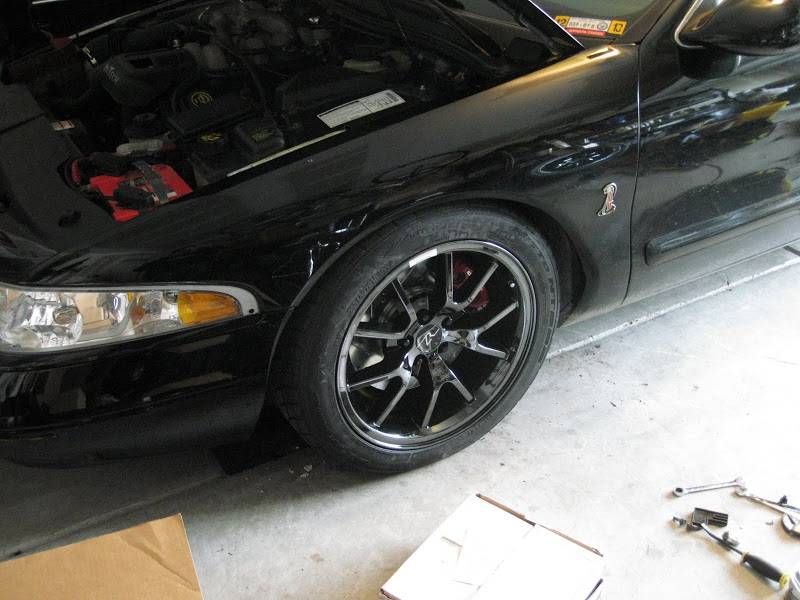

Hmmmm you could fit 295s on those couldn't you ? Or are those the 17x9 wheels or 17x10?
They're 18x10's, so you can fit pretty much anything on them (except small tires, lol). It's a matter of getting the tires to fit in the wheel well combined with the offset of the wheel.
K9t8m, I'll look into that trim tape and see what it's all about, thanks.
they look sick! my brother has a set of black chrome FR500s sitting in his room for his 07 Mustang GT. waiting on tires.
