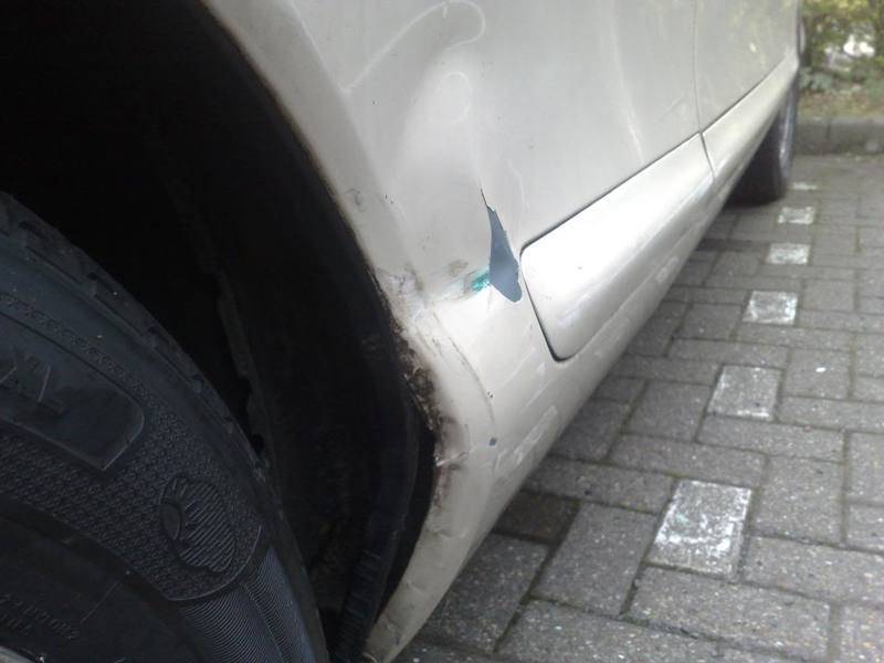

Just a small update, got all the suspension parts, rear air bags and h-pipe installed. The only thing left on the list was a wheel alignment and the amber lights, at least install someone bumped his ugly Peugeot into mine on the office parking lot... Im sure her insurance will pay for it, still pretty annoying though...
Sorry to see that happen to another LvC member. At least you know who crashed into your car. I would not call that an accident. She knew she would not clear it and went for your car anyway.
That blows..take it to a GOOD body shop, don't let your insurance dictate what body shops to take it to, the dent should be able to be massaged out but the whole 1/4 will have to be repainted unfortunately..hope they can match the paint, pearlescant isn't easy.
Thats my biggest worry right now, it won't be easy to match the paint so you wont notice anything once its done. I can only hope those guys know what they are doing.
Alright, picked up the car on Tuesday, the shop did a brilliant job repairing the dent and repainting the area, impossible to tell that someone bumped into the car.

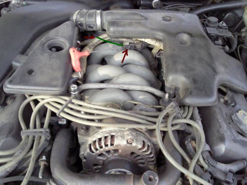

While doing this I noticed a ruptured vacuum line on top of the intake manifold (something I suspected for a while now). I followed the line, seems like 2 lines are coming out of the firewall and merge into one which goes into the T-section on the right as seen in the photos. Anyone got any idea what that might be for and if it could be a reason for my bad mileage? Also, does this line feed all cylinders?
I reconnected the line with a piece of rubber hose I found lying around for now, guess it'll take a while before the fuel management adjusts and I would feel any difference.
I believe I had defrost only! My line was broke right where your arrows are. I was directed to this vac line (to fix by the good lvc members here) to get the air to blow through all the vent's. Not sure it affect's anything else. I could be wrong though about the anything else! I dought you'll feel any difference.
+1 Mine Cracked and I only Had defrost
Ah alright, I guess it still sucked air into the engine that shouldn't be there though. The right end of the line is directly connected to a much larger line that went right into the intake manifold. The thing is, we used this line to suck some of the seafoam into the engine like you are supposed to do. I am just not sure whether this thicker line actually feeds all cylinders which would be necessary to make this stuff work properly.
