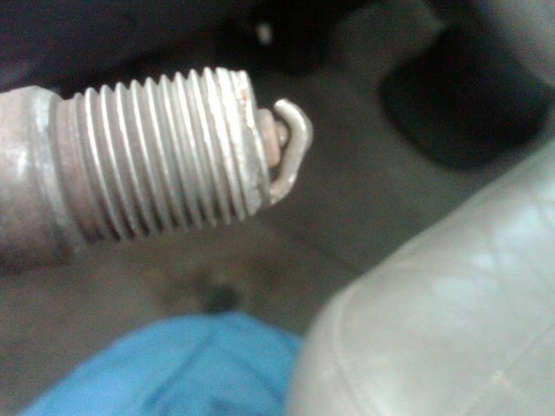

Out of nowhere last night while I was idling at a traffic light, engine started missing. Didn't think much of it since another coil or plug went.
Bought a new set of plugs and one coil just in case and started working on the car tonight.

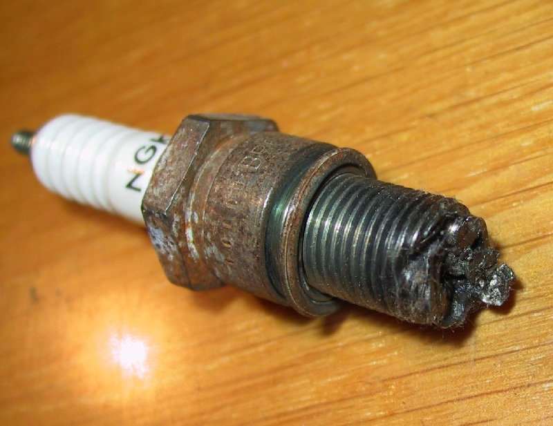

Low and behold, the plug at the back on the driver side must have been pushed out by the piston. I'm thinking a rod went. What pisses me off the most is that I baby the car most of the time. :mad:
When I crank the car, I don't even hear air hissing in and out of that plug hole either, so that piston must be stationary.

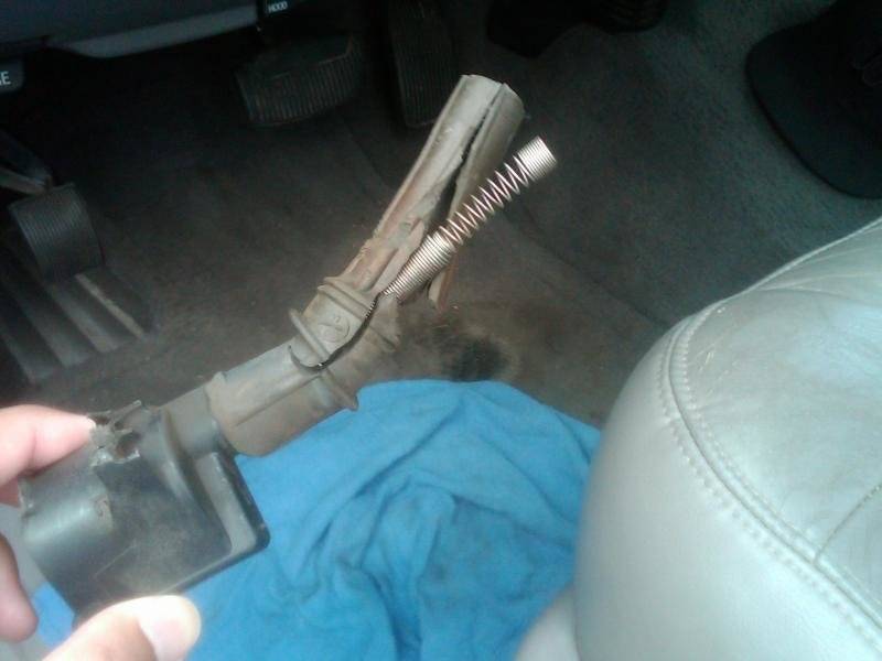

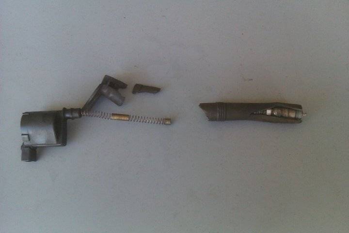

That my friend is a perfect example of bad valve cover gaskets, which caused oil to get into the spark plug channel thereby exploding one of your coils. You're lucky the spark plug threads in the heads are still in tact otherwise it will need to be sleeved. Chances are the rest are probably filled with oil as well.

When the cop exploded on my 97 5 years ago, I had to resleeved a spark iv hole, and do a valve over gasket job and it was good as new.
You really mean "when my 97 stripped out plug threads and pushed out plug and no other damage was done" I resleeved the hole. LOL

You could be right too. What I don't understand is how did the spark plug electrode get smash like that?
What I'm wondering is happening is plug is blowing up and out then the plug rebounds back down and not so str8 and the strap hits the plug well bottom?
If a plug made contact with the piston so violently that it forced the plug right out of the head the plug would have sustained MUCH more damage.

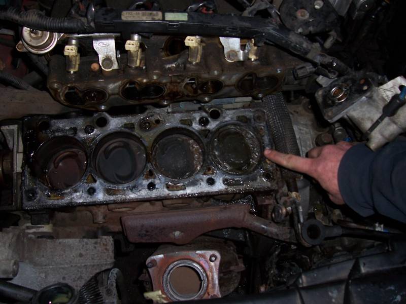

First off, we need to figure out if the rotating assembly is okay. I would get a longish 10" maybe 1/4" drive extension and stick it in that cylinder's spark plug hole. Turn the engine by hand and see if the extension moves up and down. Make sure if the piston travels down that you don't lose your extension in the hole.
If the cylinder is moving, you are somewhat out of trouble.
Next, we need to figure out why your spark plug is no longer in the hole. You sound like you have thread damage... I would get a tap that matches the spark plug threads and cover the thing in grease. Then try to thread it into the hole. See what happens. Either the plug was loose and worked its way out, or the plug pulled the threads out of the head. Ford and some aftermarket companies make a guard-cert kit (basically a heli-coil) to replace the cylinder head spark plug threads.
Get back to us once you figure out if the piston is still attached to the connecting rod.
