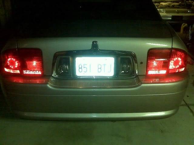

My Lincoln LS with CUSTOM LED tails
Kinda figured there was cutting involved.. :shifty: yesss.. Get to hack something up.. :D Did you use the relays to do the different functions like brake, running lights, and turn?
Yea. I had 1 4 wire relay for the brake and 1 for the signal. The 2 5wire relays were to control the coordination of the signal and braking.

As for night time pix... I just took one. I need to upload it though
Edit: Here is the pic
So you cut right into the black housing? Then what, sealed it back up with epoxy or rtv? I think I'm getting all of the tails off the parts car here so I have 4 times to get it right.. :D I've already got the designs of the boards done.. I can't wait to see night pics of yours.. LEDs make an awesome difference!
Yup. Just chopped away! haha! Then i used a mix of epoxy and rtv... so yea
