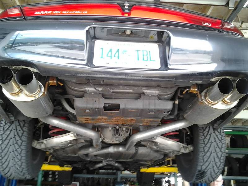

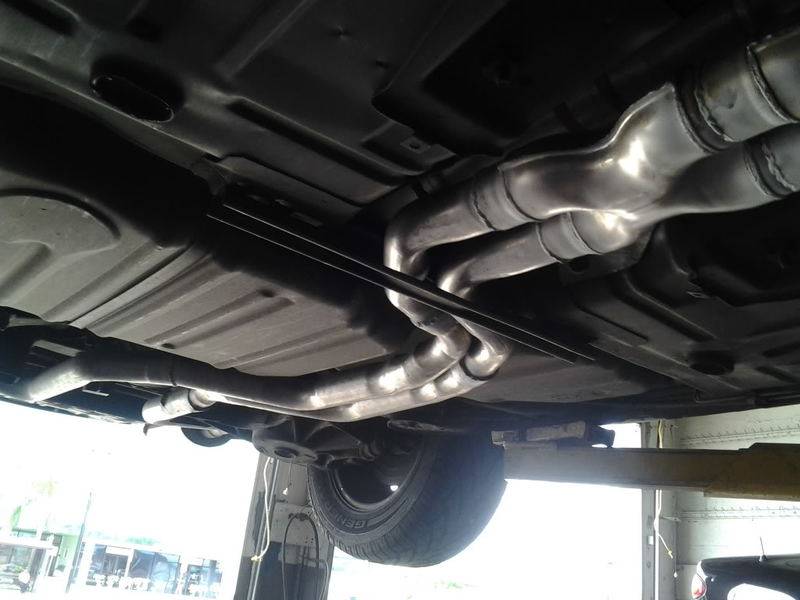

my full lenghth exhaust
ill find the sheet somewhere.but if you do the math and start with a baseline of 290 hp to start with +/- 5 hp for error and factory diff. the headers are worth 10-15-hp depending on whole system. the lms dbl x system alone is worth 25hp over stock so we'll say 35 hp.then 11-22 with the mass air setup, then tune from delta force 10 hp which they rate in conjunction from stock to full exhaust, and other mods add that get 60-70 hp for a total of around 350 -360 hp i forget where in the rpm range somewhere @ 6000. which is probobly where you are given the same mods, almost. factor in drivetrain loss between 15-20% ,some say or a total of 50 -60 hp and your +/- 5 hp and your there, mathematically.all those numbers come from the manufacturer, not me, but ill look for the sheet which i think is stapled to the receipt knowing my girl is filed somewhere. track results coming soon with gear install. watch out mr.aspirated, you still have to deal with geno whos faster than you n/a, and im at sea level. coming for you.and ive got no legs, technichally wanna give me a handicap?:D
