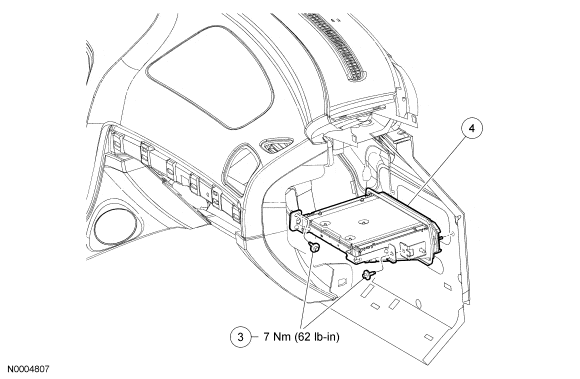

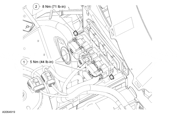

      The PCM is behind the glove box, attached to the firewall: 2006 Lincoln LS Workshop Manual
      Item Part Number Description
      1 14A464 Powertrain control module (PCM) electrical connectors (3 required)
      2 N621927 PCM nuts (2 required)
      3 606625 PCM bracket bolts (2 required)
      4 031400 PCM and bracket
      Removal and Installation
      1. Disconnect the battery ground cable. For additional information, refer to Section 414-01 .
      1. Remove the cabin air filter plenum. For additional information, refer to Section 412-01 .
      1. Remove the glove compartment.
      1. Disconnect the 3 powertrain control module (PCM) electrical connectors.
        • To install, tighten to 5 Nm (44 lb-in).
      1. Remove the 2 PCM nuts.
        • To install, tighten to 8 Nm (71 lb-in).
      1. Remove the 2 PCM bracket bolts.
        • To install, tighten to 7 Nm (62 lb-in).
      1. Remove the PCM and bracket as an assembly through the glove compartment opening.
      1. To install, reverse the removal procedure.
      Don't get a used PCM, have yours tested and repaired. Otherwise, your car won't start due to the PATS if you change to another PCM. You need the right tools to reset the security.
