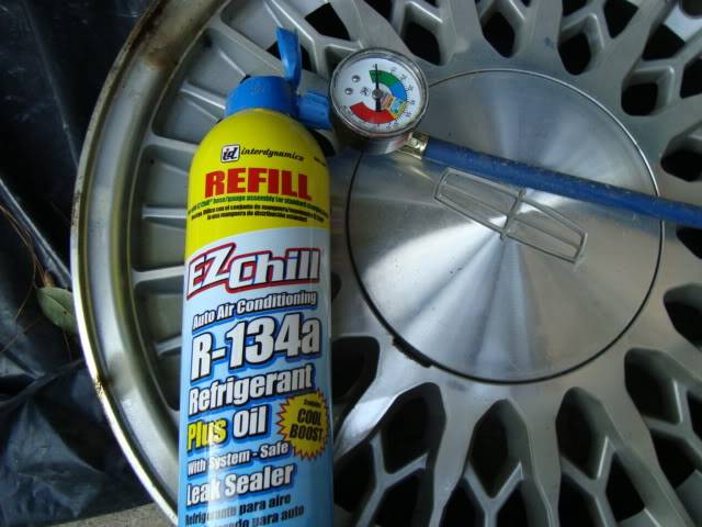

It took 3 18oz cans to fully fill mine. I used the stuff pictured below and this was well over a month ago, maybe longer and it's still blowing cold and still holding the same pressure. 39 to 41psi
Well, if you use 3 18oz cans I guess I could try at least one 18oz and see what happens. Did you get those 18oz cans at Walmart?
Walmart has that brand but originally I got the first two at O'Reilly's. You really need the gauge to make sure you don't over fill. Can with gauge is about $22.00 and without is right at $18.00

This post made me want to recharge mine, the air blows slightly cool but WARM on hot days like today. For some reason when i hooked everything up the ac system would not suck in the contents of the bottle? My ac was blowing and it was on MAX also. I thought i forgot to remove a seal or something from the bottle, not the case etc. The pressure was in the middle of the green on the gauge i checked.
Last year she sucked on the bottle good lol, today nothing and i used the exact setup that EZchill one.

Could be possible but all I know is that the gauge is reading good and it's cooling good. Maybe what they say is in the can, really isn't. The gauge is showing 39 to 41 psi and it's blowing cold at idle, slightly cooler while driving.
