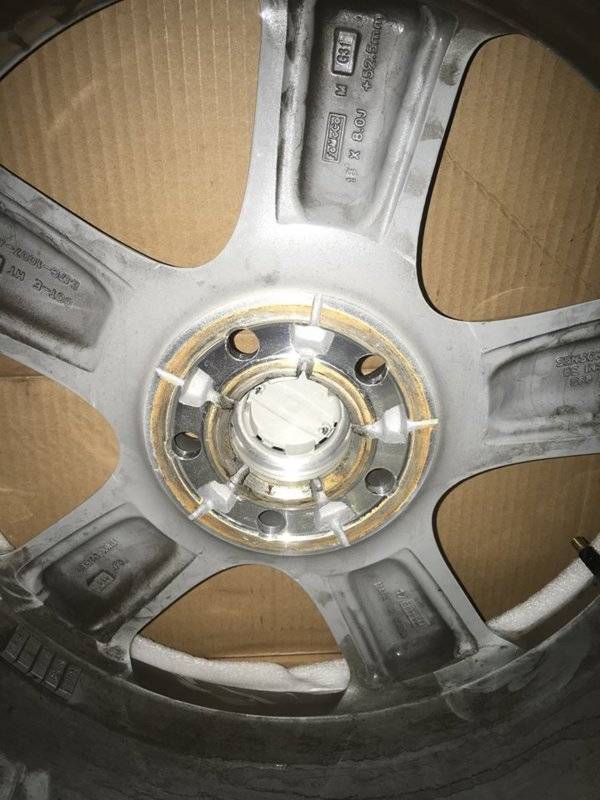

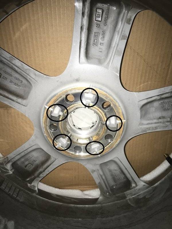

          1) Front wheel spacer: 20mm, right? with the spacer, how much of the existing lug sticks past the spacer? I presume your Zeus wheels have the space in between the lug holes for the existing lugs to fit into. What I am wondering is what is the smallest spacer w/lugs I could use that would work? IOW's, 20mm spacers seem to work, would 15mm spacers work? I can double check how deep the cut outs are on my wheels. A picture is below...

          1) I actually use a 20mm hubcetric spacer/adapter which has it’s own studs coming out of it so no issues with it at all. Got a new pair recently for about $100 from ebay, aluminum in black. They are great.

          I realize the spacers come with studs. The spacer is bolted onto the hub using the existing lug studs. My question is how far do the existing studs stick out past the spacer. I want to make sure any spacer I use is thick enough so that the existing wheel studs will fit in the circled holes.
