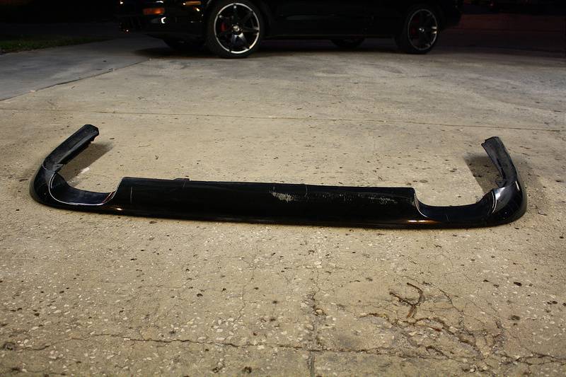

2000 LS V8: (note) Im going to be installing a gen 1 LSE rear valance so keep this in mind.

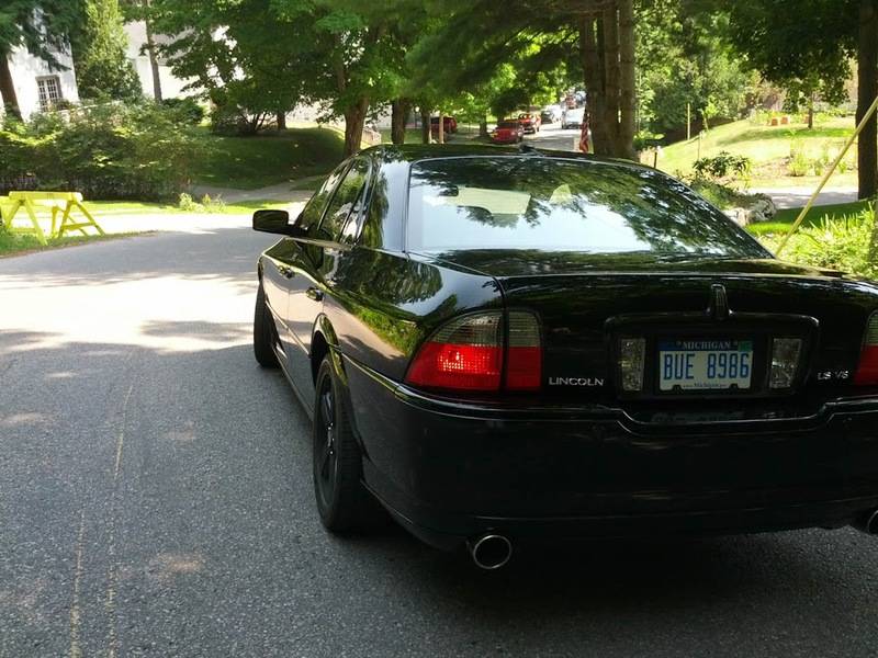

Lol no, Im in Ann Arbor Michigan, and we just had our first sleet, hence my confusion for the rust.... Well, here is a picture of the back of my car real quick from many months ago. Ill get you another one tomorrow so you can see it a little closer and get an idea for what it looks like if you want. I can have it uploaded by noon

The x factor in this is the LSE rear valance cutout. It does match the standard placement of where our gen 1 mufflers usually lie(too far to the outside for the lse cutouts). There seems to be a few ways to get it match. Hite angled his and worked fine. I had my mufflers(Magnaflow catback) cut out and reversed to get the center in to become center out and matchup. There are options.
Manoli is just weighing his options on how to make the right mufflers match the cutouts on the first try.
