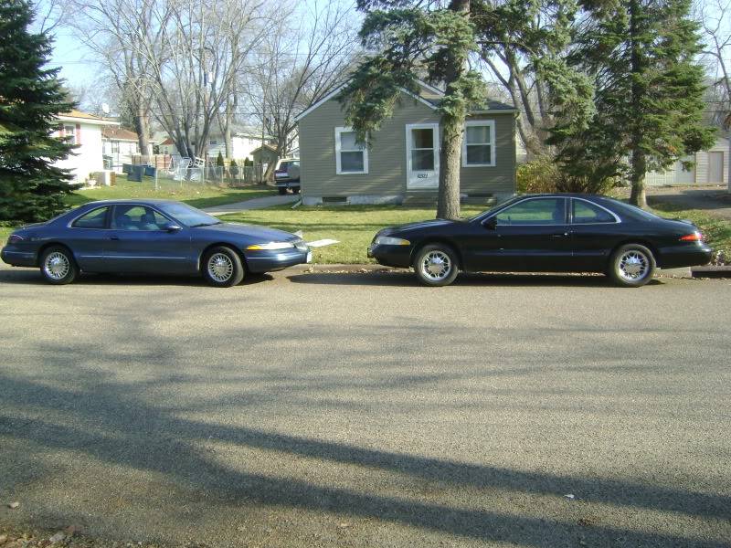

here is a pic of a 93 at stock height and a 97 stuck in 4x4 mode.
Mine was in 4x4 mode because the vent was plugged.

my 98 looked like your 4x4 ford nut without a plugged vent, maybe the gen2's sit higher, cuz i remember i could see the entire upper control arm at stock height

I dunno, when I replaced my pump it came down to were the 93 is I guess it just comes down to were the sensor is set at.
