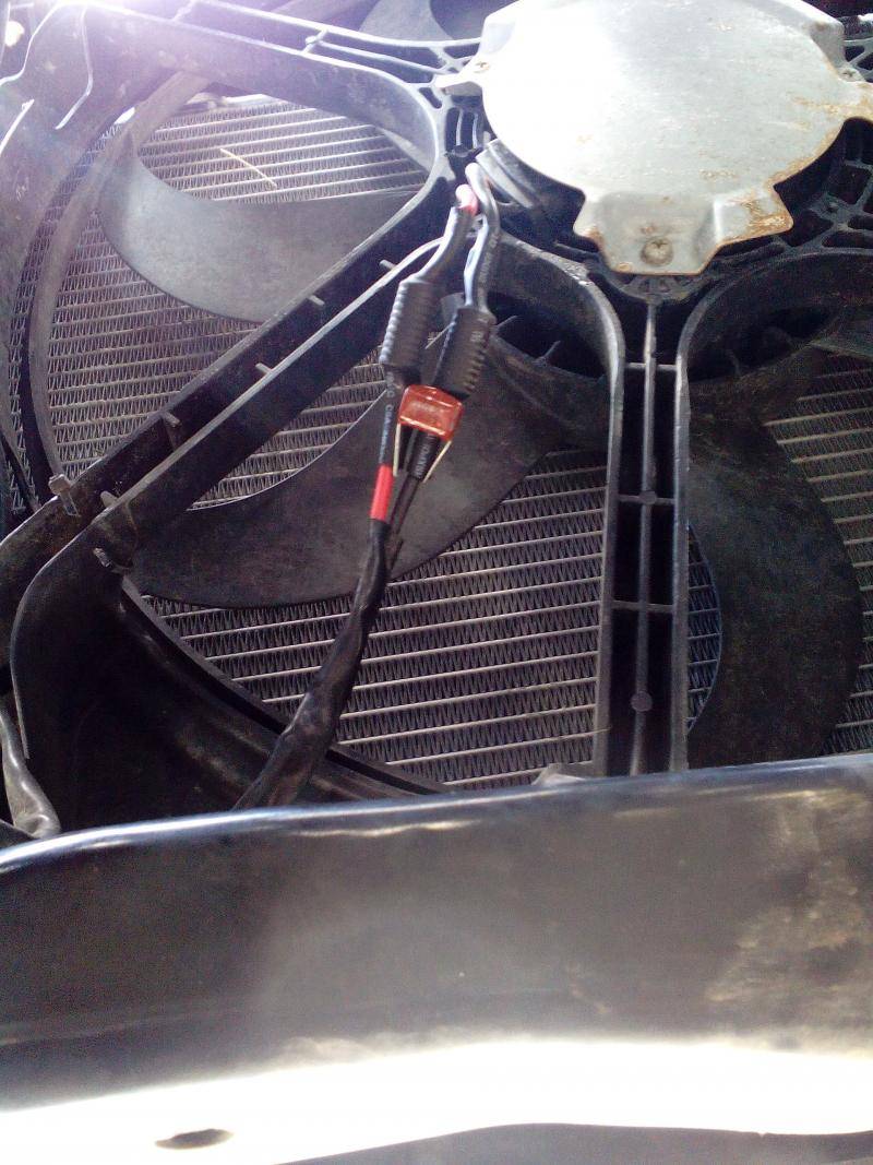

However, the first thing I do is test the fan motor itself. I ran a jumper wire from the positive battery terminal to the positive fan motor wire, and it turns on full blast. So the fan itself is fine.
Now I just need some help with further diagnosing (Unless someone tells me that I know all I need to and advises me on what needs replacing). Anyhow, I believe this is the thermoswitch...
And I need advise or a procedure on how to diagnose if it's bad (Again, if advised or nesecary).

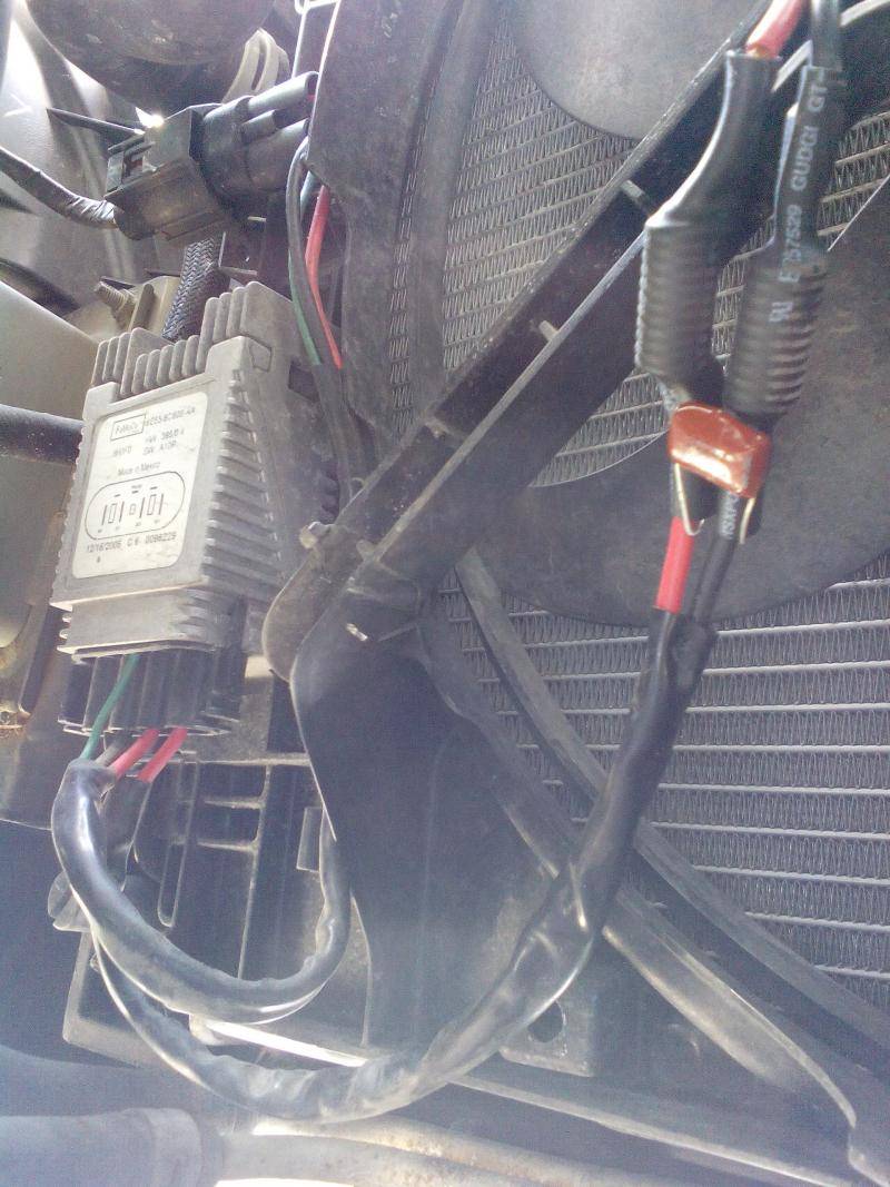

And I believe this is the cooling fan control module...
And I need advise ora procedure on how to diagnose that.
