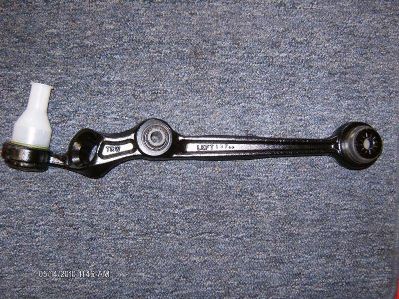

You did good getting the Moog K80055/K80053 T-Bird LCA's, I bought mine from Rock Auto, and received TRW stamped parts.
