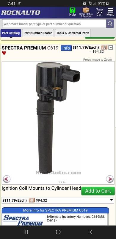

"I'd put the correct plugs in, and set the gap to exactly 1.0mm."
I couldn't agree more with this statement...I've found that the Lincoln LS works best with NGK plugs properly gapped...ppl who have owned these cars have had the best luck with Motorcraft COPs but My 2002 LSE V8 hasn't had a single misfire in three years after replacing all 8 coils with these
