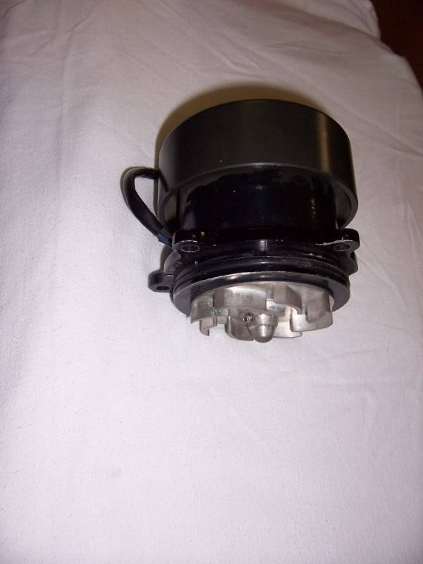

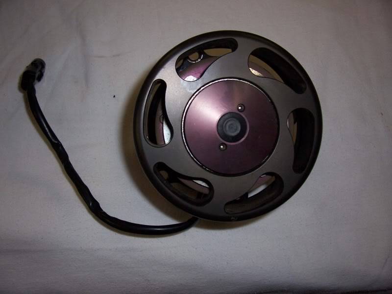

Had these pics hanging around thought I would post so others can see what this really looks like. This is Meziere #346S "S" for street with built in idler. I didn't take pics while pulling and install probably from my hands being covered in antifreeze.
Here is the close up front shoot of pump

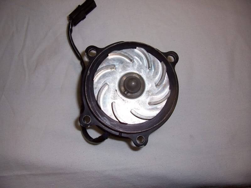

Here is the back shoot of pump and the billet impeller. Here you can see the 4 bolt holes that hold pump on engine.
Here you can see O ring on pump and how it plugs right into the engine.

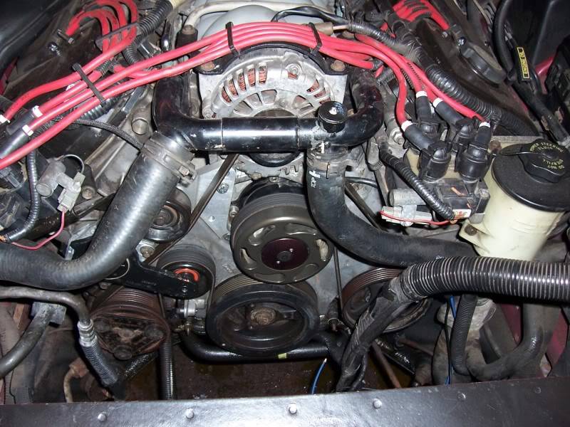

Here is the pump mounted on engine and belt on. The mounting of this is one of the easiest mods ever. I don't have any pics of the wiring sorry.
