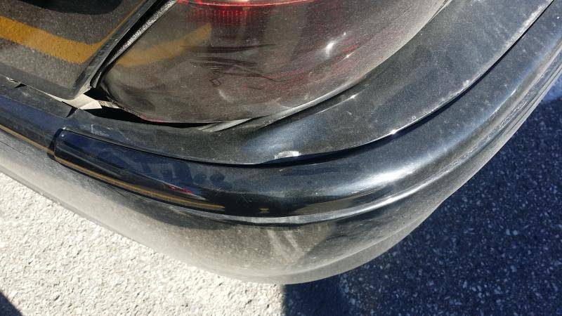

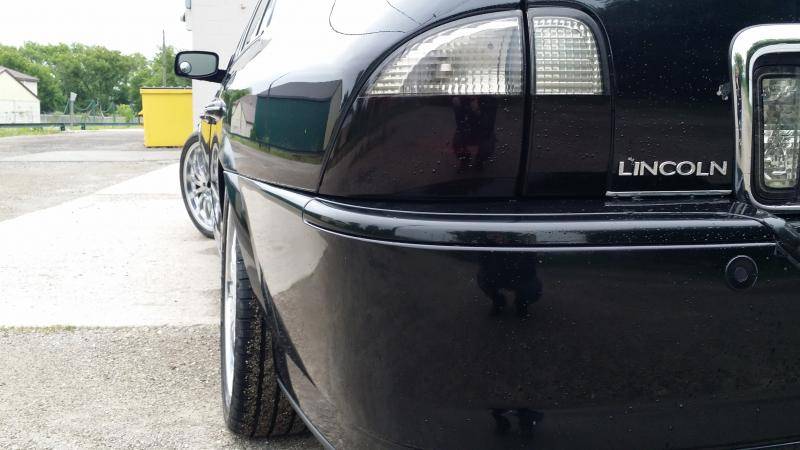

Hi,
So I have an 03 Lincoln LS and I tinted the lower half of my tail lights. It looked really good, and when I went to go put my led bulbs in I realised I had melted my rear bumper and tail light. I knew it was problem hence why I bought led bulbs I'm just pissed it happened right before I went to change my bulbs. The tail light I'm not too concerned about because I have a spare, but my real question is if I can get my bumper to go back to normal? I've popped out dents before on plastic bumpers, but wasn't sure if the sinking of the plastic has completely ruined the integrity of the plastic.

You sure the bulbs caused the problem? Not the exhaust or something? That's a major flaw that should never happen on stock lights with stock bulbs... Especially not little brake bulbs.
It would take a LOT of heat to cause that type of distortion, was it on both sides or just one? You might want to poke around and make sure it isn't being caused by something else.
this may be just me, but I dont think there is any way the rear lights caused that bumper damage, no matter how dark they were tinted...
I would expect the tail light to turn into a puddle of melted plastic before the bumper got damaged.

The reason I assumed was tail lights was cause I have seen other people tail lights melt. I also switch my dial to 3rd setting over so my tail lights were on, while driving for about 1hr 40 mins. Also the under side of the lamp is distorted as well so just automatically assumed was light bulbs. It wwas just the one side which kind of confused me. I don't see it being my exhaust because it's cut of just in front of rear tires and was driving 100km + majority of the time. Maybe I'll look in and around the area a little harder again but I couldn't see anything.
but with driving, there should be plenty of air moving around to remove heat, I could maybe understand the lenses getting a little distorted but it definitely shouldn't have been able to reach the bumper, at least that far out.

It is the exhaust dude, it has nothing to do with the bulbs- yes the incandescent bulbs will melt the lens slightly, but this is very mild. Your damage is a large heat source for a long period of time.
And you said you drove for almost 2 hours straight when you noticed it. Your exhaust is very hot, and it is building up in the corner(s) of the rear bumper, the points of melting in your photo are exactly where the heat would be forced out @ speed. The little plastic corner inserts and the taillight/trunk/bumper seam. The reason the taillight looks like the culprit, is because the taillight is blocking most of the heat escape. These bumpers have no venting for air underneath the car to escape from, so it will force out of the confined spaces exactly where yours did.
