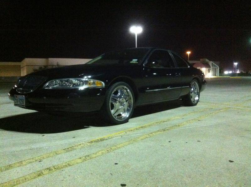

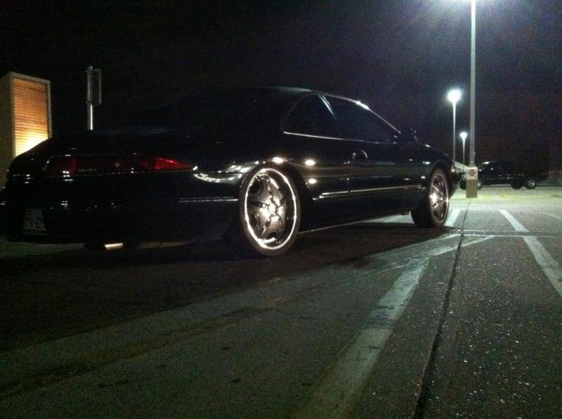

Gorgeous Mark dude! wish mine looked that good, maybe my daughter (14) wouldn't dislike it so much... she says it looks like an "old man" car and calls it the Hearse. :confused:
