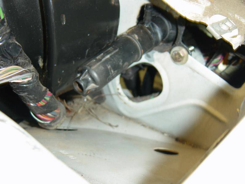

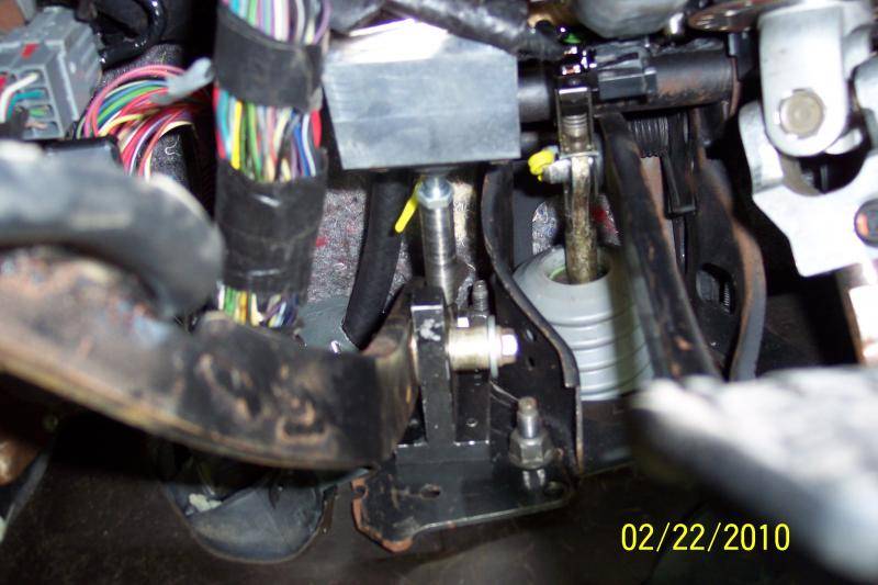

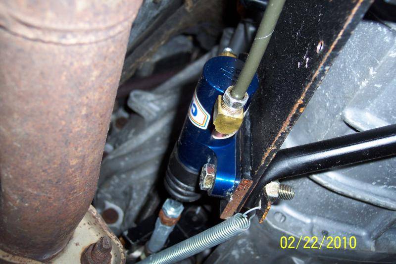

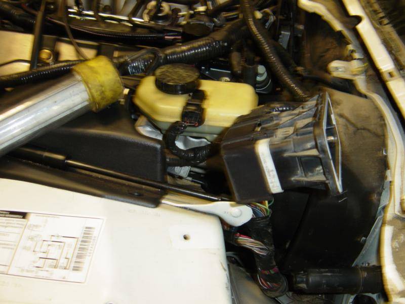

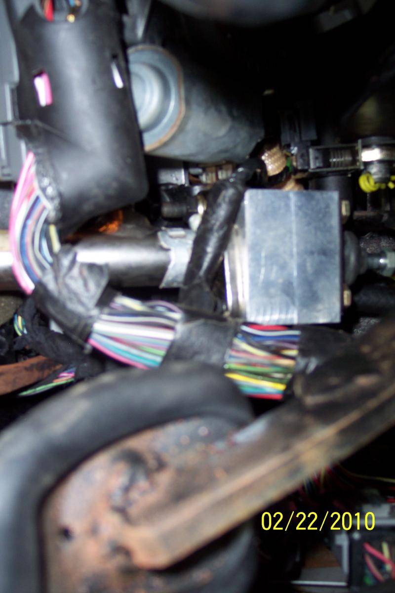

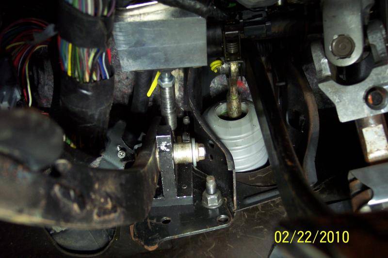

converted my m8 to a manual trans. Too much fun! My brother Custom fabbed a clutch/brake pedal assembly that has the master cyl on the inside of the firewall (reverse actuated) so the only thing going through the firewall is the hyd hose to the slave cyl and the resvoir hose. resovoir is mounted close to the front of the engine. Also made a bolt on bracket for the slave cyl. (no welding on the trans) Im back overseas and my brother hasnt taken any pics yet. He wants to buy a cadcam plasma cutter and turn out another assembly for testing.
