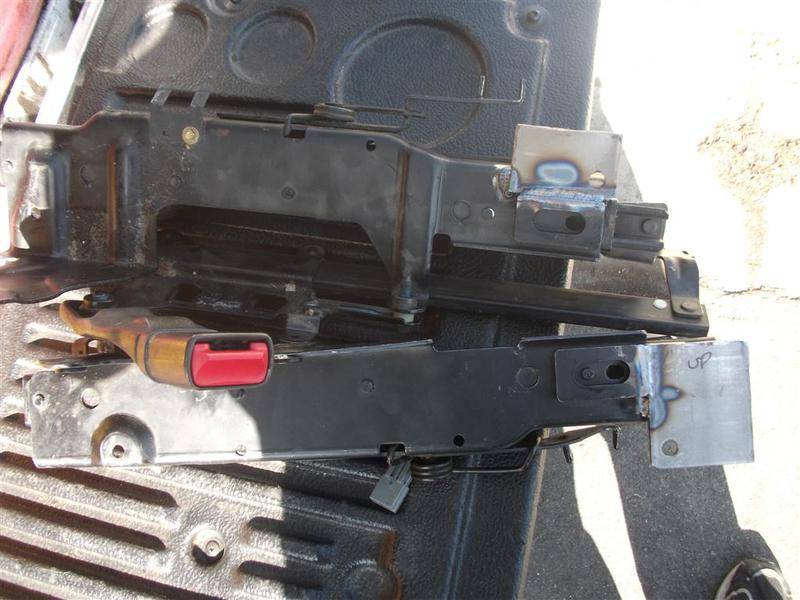

I've got everything all set in the car right now, all except the front two seatframe to seat rail bolts that don't line up, and I've decided to continue with the conversion. I'll take some additional pictures, but what I'm going to do is have my friend weld up a little plate on each side of the seat rail, so that the mounting point is essentially brought in an inch or so on each side in front, then drill a hole through my mounting plate. There is just the perfect gap between the rail and seat frame to get a piece of metal in there, and safely weld it up. I'd prefer to do it that way rather than relocate the studs in the plastic seat bottoms...only because it's plastic, and I don't want to chance having it tear out if I do it incorrectly.

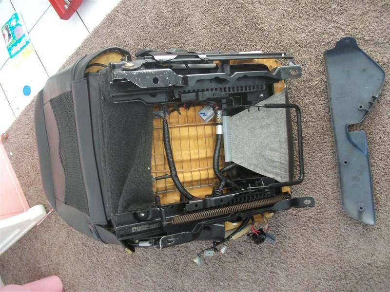

I wanted to leave the seat itself as stock as possible in case I want to revert to the power motor setup again in the future. For this reason I didn't swap the seat bottom, or redrill the studs on the bottom.

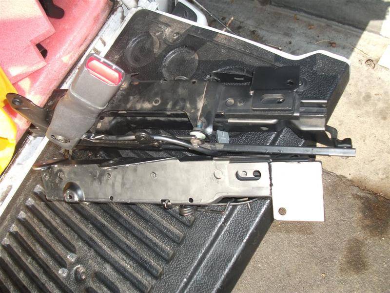

I chose to take the brackets to my friend. I measured and cut steel brackets, which I had him then weld in the spot needed to extend out my mounting flange. After he did that, everything was a straight up bolt on affair, with the exception of the right side bolt that goes between the bottom and the seat top, the pivot bolt. I just had to add a nut on the backside. My new brackets are as strong or stronger than something the factory would have added, and they sit exactly flush to the bottom of the seat.

Only two problems I see is the side plastic piece, or the lack of it now, and the fact that a couple of the seat upholstery snap locations are missing now, so parts of the seat material aren't pulled as snug as they could be.

this is a shot of the rails with freshly welded brackets
after a little paint, you almost can't tell they're modified
and the final product with the manual seat tracks installed onto the bottom of the seat. Since the couger rails are a direct bolt on to the mark viii floorpan, no other mods are needed

It looks as could be expected...a seat without the side plastic cover on it. Looks alright for not having the cover. I could have spent some more time, and I may still yet to find one and adapt one to get the finished look, but I just had to get the car going.
